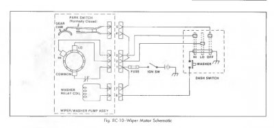

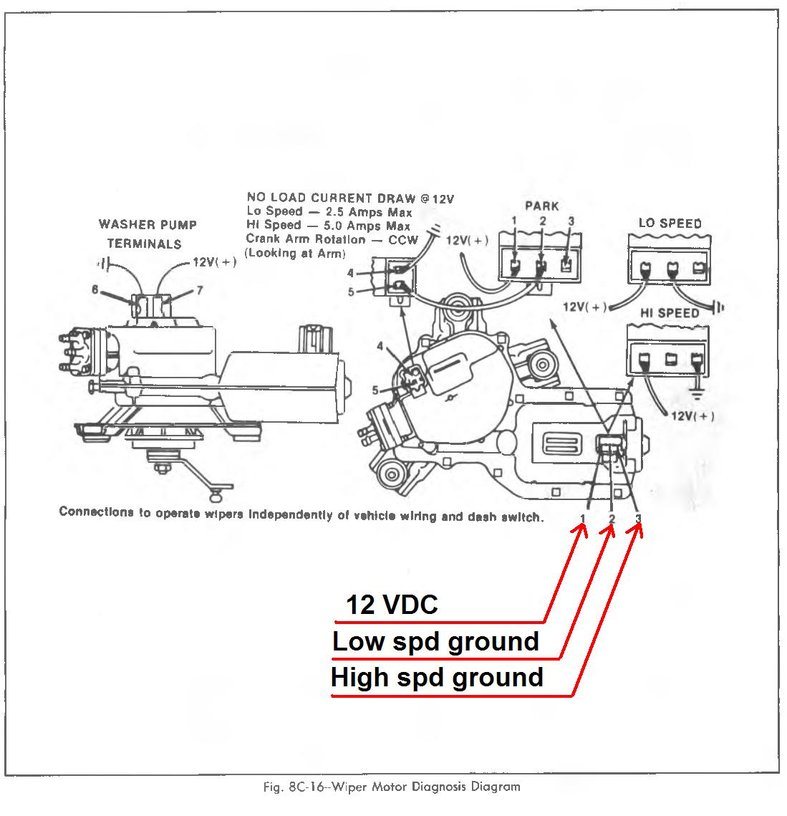

Refer to the dwgs below.
1. Get a cheap multimeter or a test lamp. Pull the 3 pin connector from the motor and confirm that there is power to the common brush at terminal 1. That means, check for power at the connector - not the motor. There should be voltage - you can hear the washer pump relay working and it shares that power supply.
2. If power is available, see if you can run the motor locally by providing an independent ground path for the HI/LO brushes. Unless you want to cut into the wires, the connector will still need to be unplugged. You will need to provide power to terminal 1 - as well as a ground for the brush to be tested. Just use alligator clip type test jumpers. Connect 12 volts to the common brush on pin 1 and then ground the pins for both brushes - one at a time.
Do those tests and come back - someone will explain the next steps.

So after work today I checked the plug with a volt meter and theres good voltage going to the plug. Unfortunately I didn't have the stuff to test the motor by itself. With the previous comments I feel its the motor. I'm hoping to return the current motor and get a replacement in the next couple days. I'll give a report once I get a new one installed. Thanks everybody.
