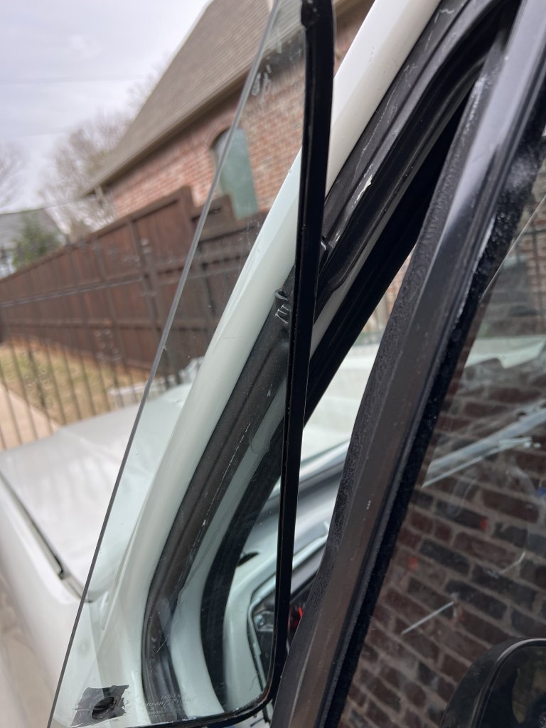

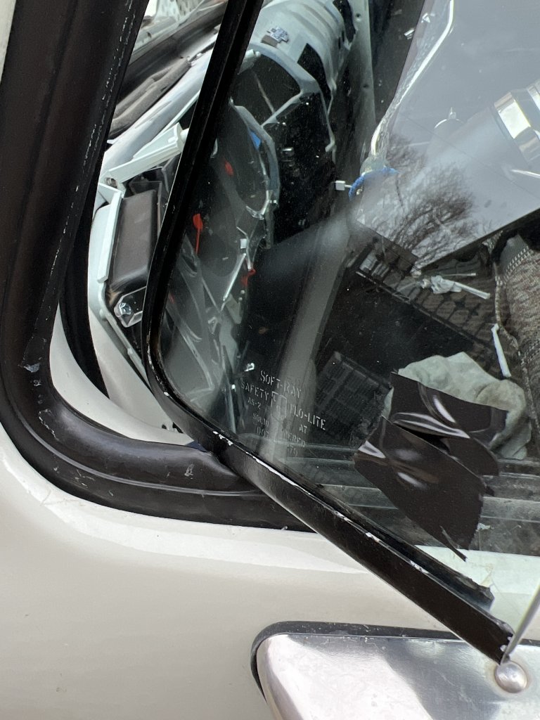

He just did Easton’s vent window that got broken during the freeze a few weeks ago when E pulled on the Handel a little hard.

Matter of fact when he set new vent window Saturday, he used the same sealant to mount glass in vent frame. No rubber insert strip….
