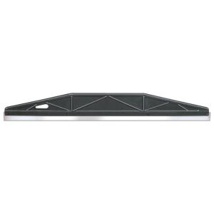

I got mine from classic parts. I ripped all mine out when I had it painted. So far, I've only reinstalled the DS felt. Just installing that made a huge difference in the road noise. Been too darn busy to get back on it lately. I will tell you that, unless you're pulling your door panel off, getting the felt channels back in the door is a BEEEYOTCH!!! Thru trial and error, what worked best for me was to snap in the little plastic anchor and metal clip at the top first. Then (w/window all the way down of course) take a spray bottle w/dishwashing liquid and generously spray a stream of water down whichever slot you're going to try first. I set the nozzle to STREAM instead of SPRAY. Then I wet the back side of the rubber and slopped dishwashing liquid on it starting at the bottom first, the working up about 8-10". Then I dripped a little stream of DW liquid down the track. After all that, fold the channel into a V, stick it in the track, then start sliding it down. Only try to push about and inch or 2 at a time so it doesn't just flow all over the place. Just keep adding DW liquid and water as you to go keep the track and the back of the channel slick. The last 3-4 inches were the worst. I ended up taking one of those 24" paint shields and using it to stick in the door down to where the bottom of the channel was, then push down on it so it would essentially pull it the rest of the way down. I was scared the paint shield was too sharp and would just slice the rubber, but it didn't seem too. The one I used looked like the attachment. Anything long, flat and sturdy should work though.
