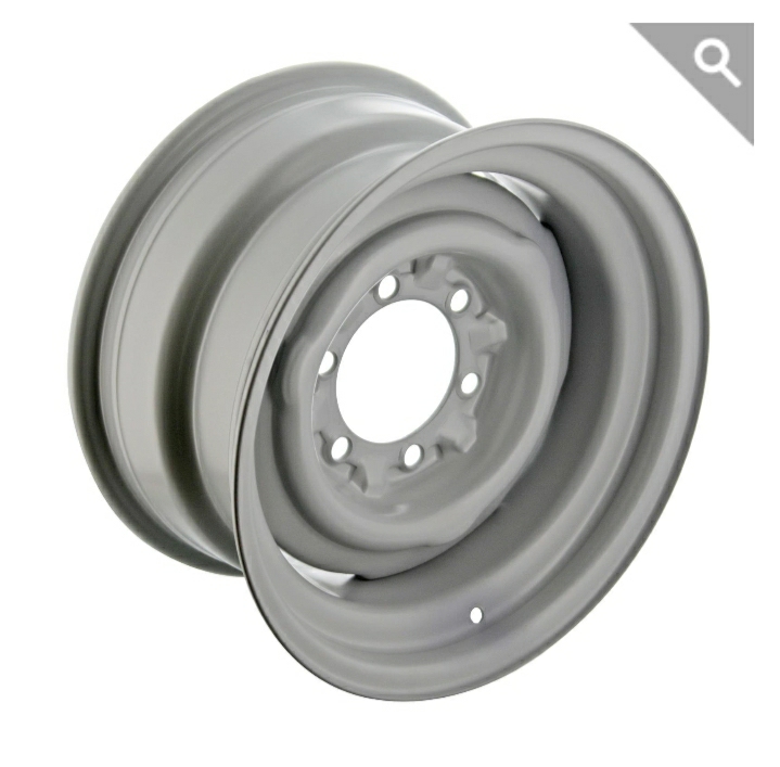

This is what it looks like

This will fit no problem
