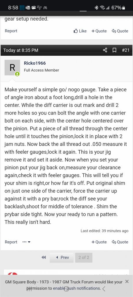

BRB okay was going to write this for you. But ended up writing it for someone else. Here's your basics. I'll give you more tips,trucks and details as you go.
