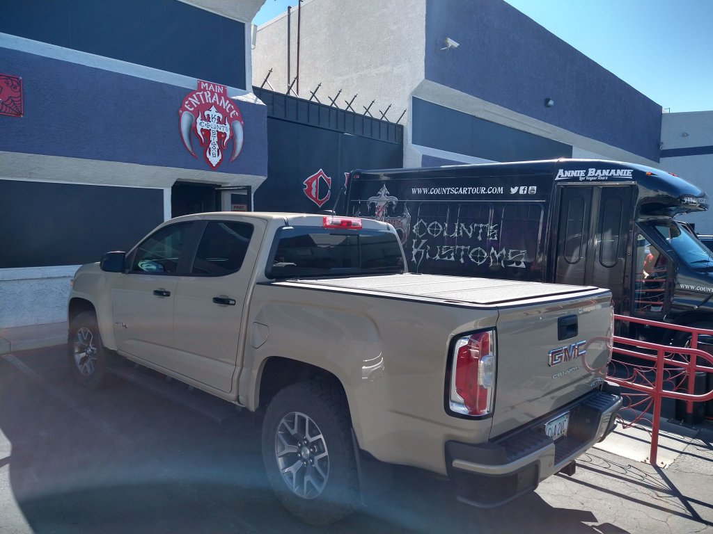

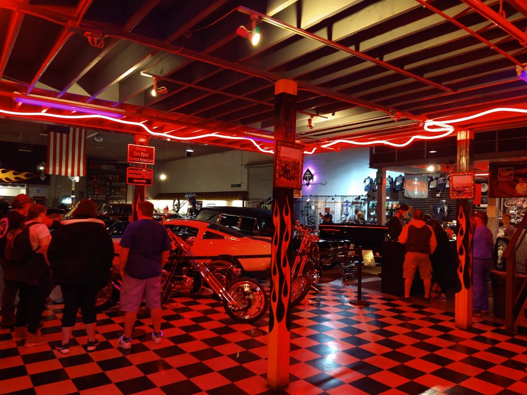

That's how I'm doing my next build. When I find a clean 89-91 K5, I'm dropping it off at Danny's (aka the Count) in Vegas, telling them to install an LS3 Connect and Cruise package, paint it and call me when it's done. I have done the "One piece at a time, didn't cost me a dime" approach. Too old to do it twice.

Do you want Horny Mike to Work on your truck ? :popcorn::yucky::think::Stupid Me:
