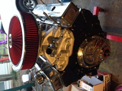

Got it kinda shiny now.. Painted it gloss black and installed most of the bolt ons.. Hopefully will be dropping it in next weekend.. I'll have a better post an more pics soon with the details.. Thanks everyone!
That looks awesome.
