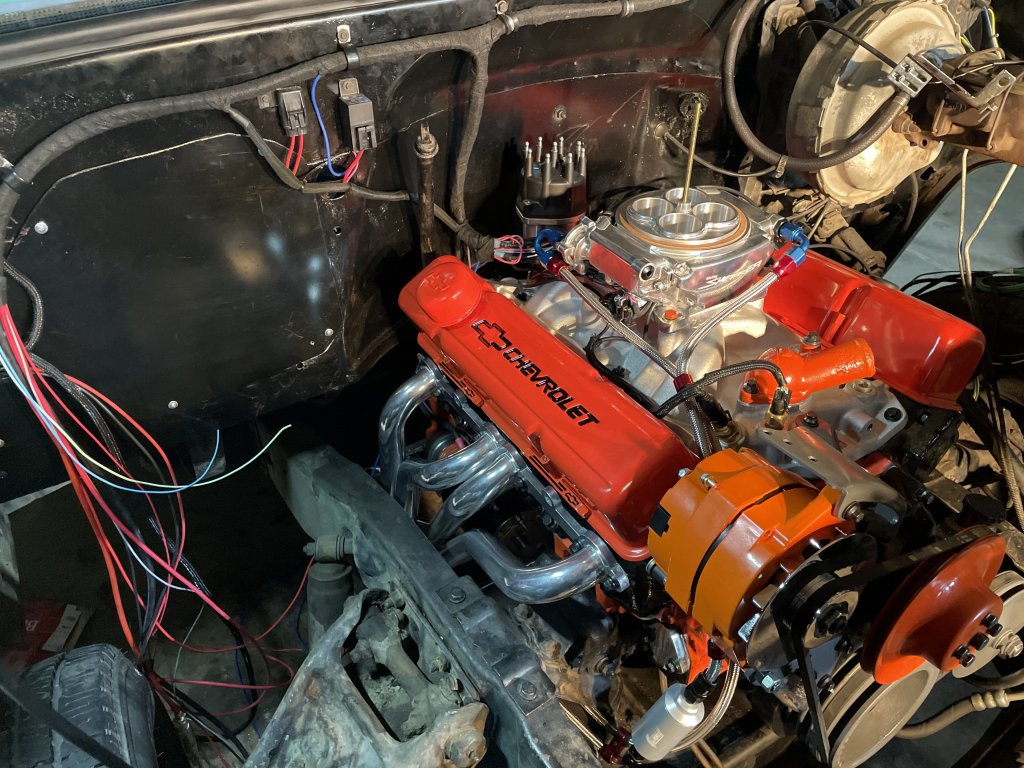

Just wanted to update this thread, I went with the painless harness. I can’t say enough good things about it.
Also is that a cast bracket for the ps pump(as opposed to the multipiece ones originally came on these)
