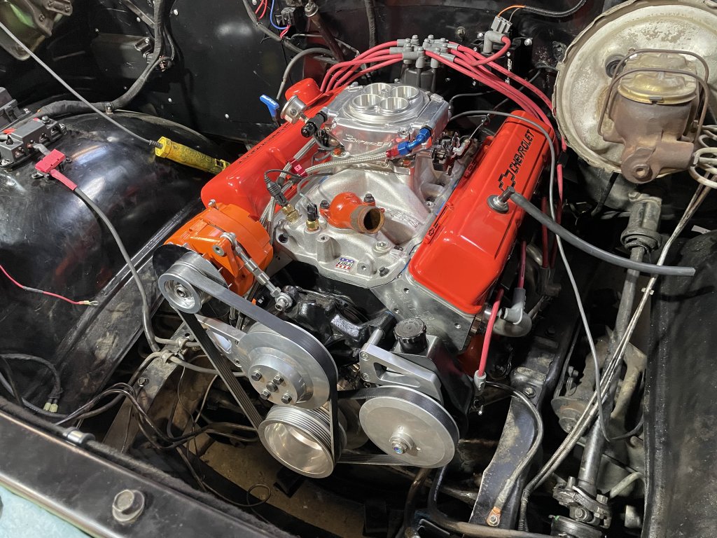

4 belt crank pulley, what product did you use for that? i think @SirRobyn0 may be curious too lol
Thanks for tagging me, yes I would be interested though in the picture it looks like a stock SBC 4 groove off a medium duty truck. We'll see what he says.

Also is that a cast bracket for the ps pump(as opposed to the multipiece ones originally came on these)
The alt bracket and 4 belt pulley were on the truck when I got it, no idea on the story of how they came to live on there but they are gone now, in fact the motor in those photos only stayed in the truck for a few weeks after the wiring project. This is how she looks now.
Those 4 grove crank pulleys are pretty hard to find. AFAIK they came on medium duty SBC trucks, so there could be 2 belts over the A/C & P/S and another 2 belts on the alt. If you still have that 4 grove pully and want to sell it I would be interested.

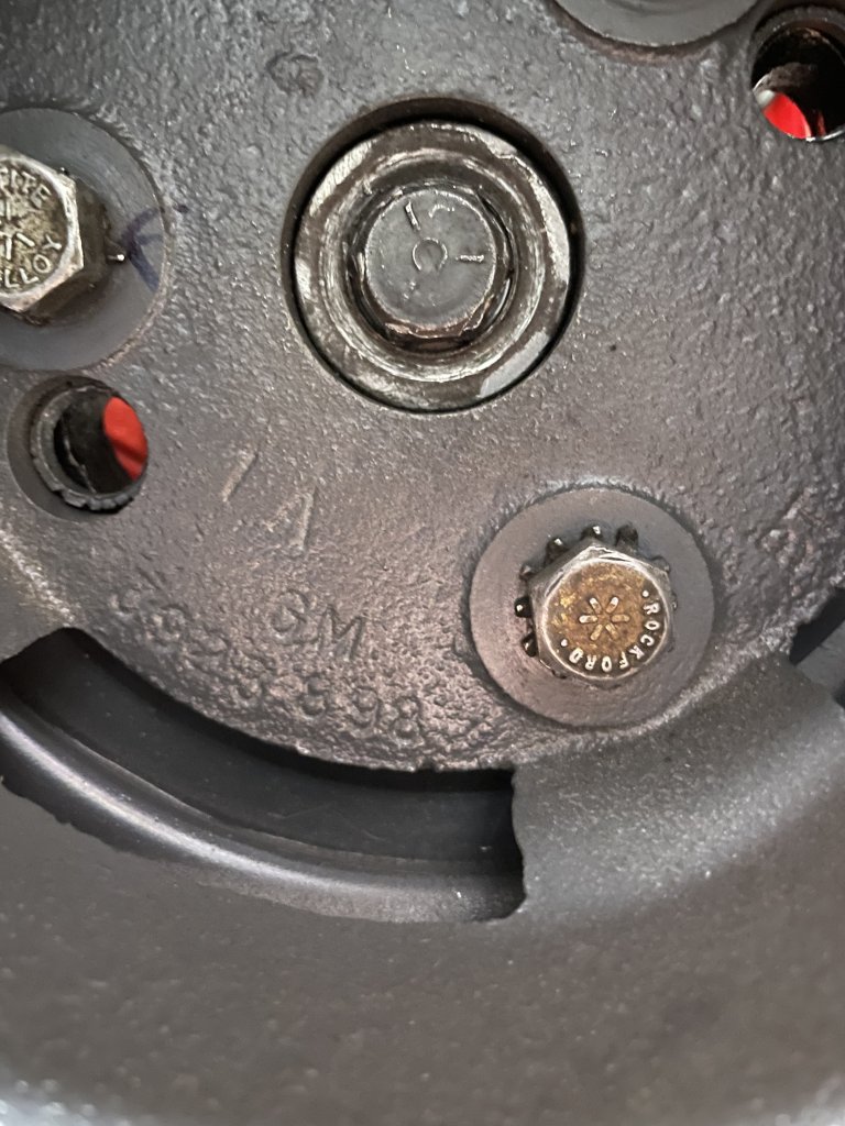

a part number if exists on it would be cool too
Jacob Miller
Oct 8, 2020
25
20
Socal
It’s hard to read at this point but the stamping on it seems to read 3923 898. Anyone that needs one can have it if your ever heading through the Coachella valley. Asking price is a cold beer and a few tall tales.
