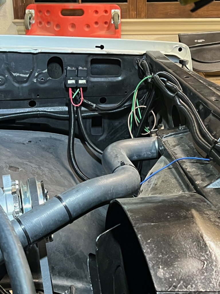

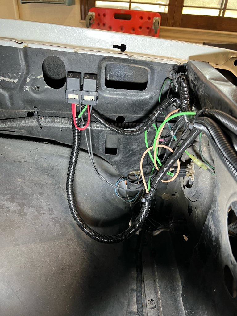

Painless made right here in Ft Worth. we have a used a few of their components (door jam switches and interior lighting)and the showroom here has great setup to show all the harnesses. We have also used American Autowire and the quality is top notch (have the headlight relay kit )

here's a current picture of my setup
That clam shell comes in half one side is the front and rear lighting the other half is the engine controls. I used painless wire loom on the side that is done. I also used some of their wire.

I like it. have some fan controlller relays than need a common junction!
