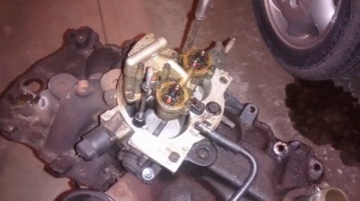

Well... I acquired a 454 TBI today. Wasn't necessarily intending to, but I did. A couple of guys and I were discussing various swaps at work one day, and TBI on my '79 came up. One of the guys says, "Hey, I got a 454 TBI and intake at home. Wanna buy it?" I said, "Maybe, if it was $25 I might." So he brought it in for me today. Mine now. I obviously can't use the intake, but now I have a piece to the swap if I do it.

You stole that TB for 25 bucks!

I haven't even paid him yet... but he knows where I work and live! :cheers:
