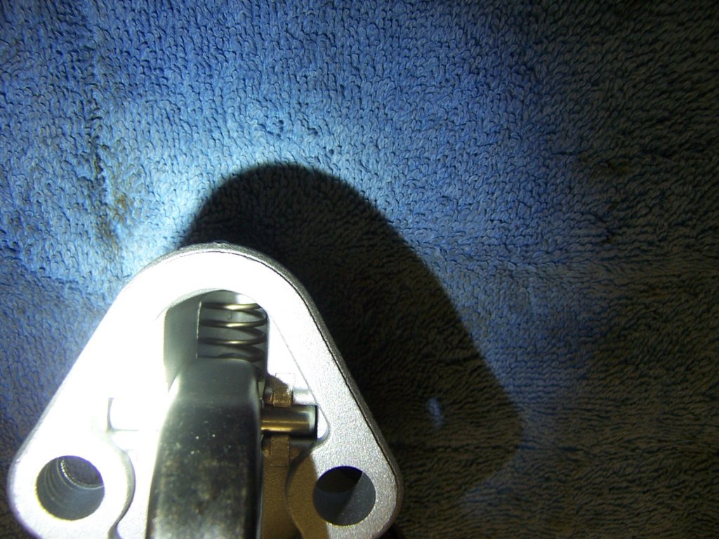

Went through a couple new bad pumps. What I found was the cheaper ones did not have a return spring on top of the pump arm. The arm stuck 1/2 way down resulting in low volume. When I finally found pumps with a spring bought spares. Both are 3 line one is a Delphi other is AC. Not sure if it applies to a 2 line pump.
