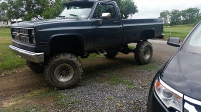

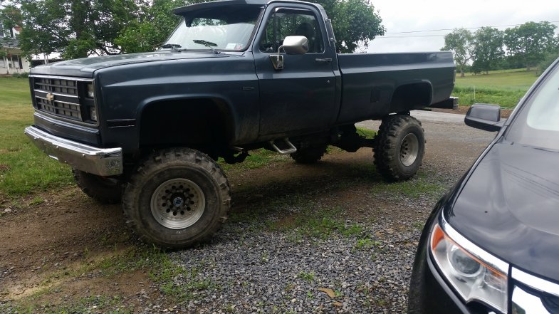

Here's a pic of the front end. Def 80s
firebane
Jul 10, 2014
1,732
30
Calgary, AB
Curtis
Yup 80s front clip

I'd say that whole body is from the 80s. You have the newer style mirrors, the newer style square headlight front clip. The bed has doors for the gas tank (think they came out in '79) Do your vent windows have the little locking button on them? This was something from the 80s.
What front axle do you have? D44 or GM 10 bolt? They got rid of the D44 in '78 (ish).
Engine cross members changed I think in 1984. The older ones are more prone to cracking. I'm having trouble finding a pic of cross members... I'm sure someone else on here has some.
Do your front brake lines go thru your frame? Or are they attached to a bracket below the frame? This changed in '79 when they went from 7/16" banjo bolts to 10mm.
That will give you some more clues as to what you have anyway.
