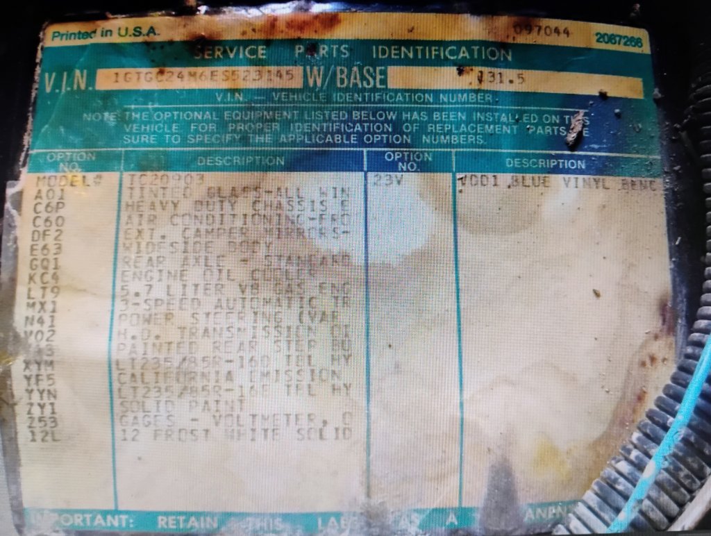

He said the under hood sticker was missing. I was asking about the Service Parts Identification sticker/label that should be on the inside of the glovebox door. I will list the engine code (LT9,LS9,LE8 etc).
SPID is shown in post #7.

Post #7 is from Juke22, who I sent the parts manual pics for his 86.
Post #23 from Paul @84GMCSierra is asking for charts for his 84. That's who my SPID question was directed to, just trying to help out fellow ol truck lovers. Doesn't seem right to be calling the 86 crew cab an ol truck. I bought it in 88 with 29k on it.

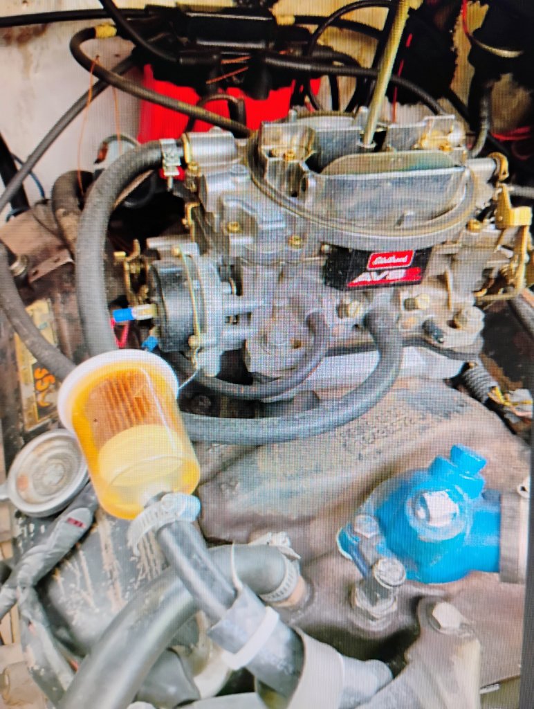

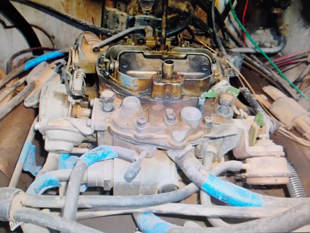

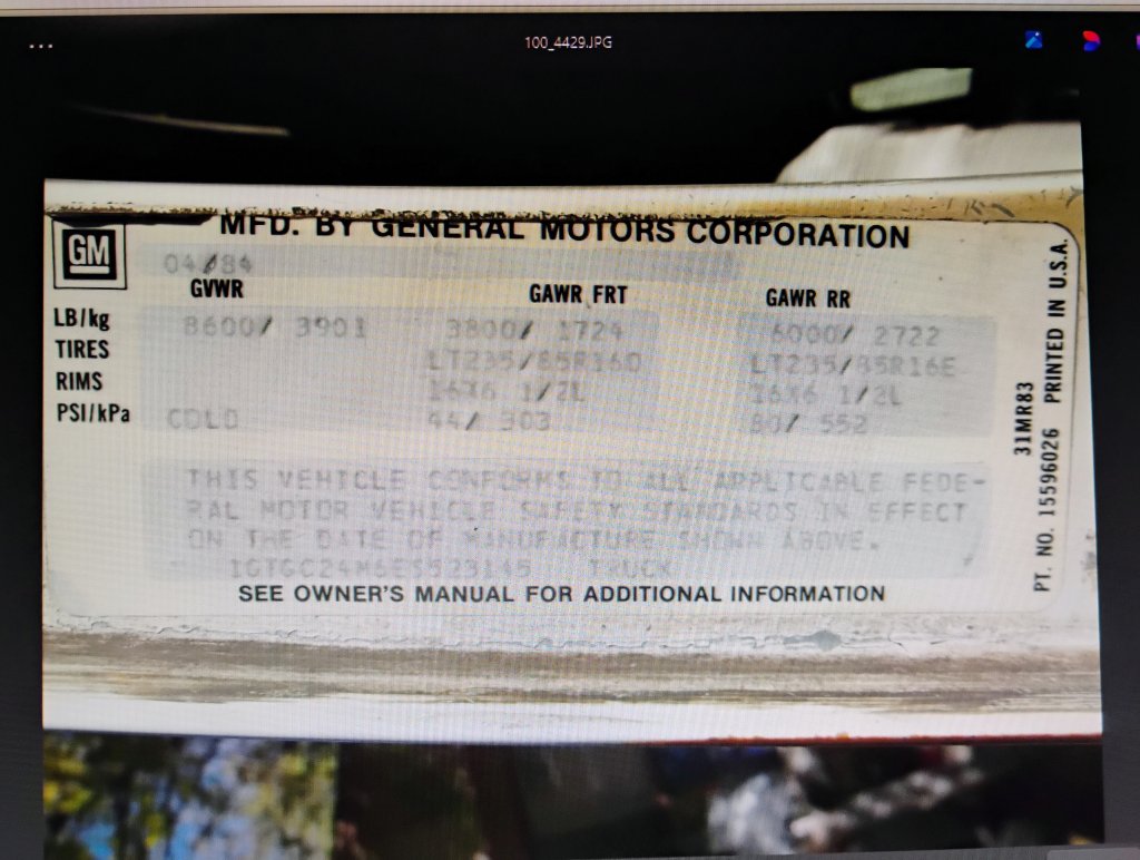

Here's the tags, and SPID on my truck, as well as a pic of the QJet, that was on it when I bought it, and the Edelbrock that's on it now.
