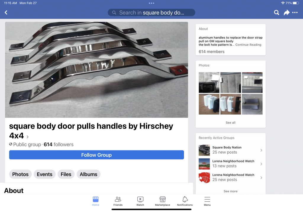

Check this FB page out, he has some different options.

Looks nice but the angle is kinda steep on that one. I sent him a message asking if he could make them a little shorter. Could be a good idea if it had say... the middle section wrapped in leather. With only each end still showing the polished steel. With those mods, someone unfamiliar with the trucks could reasonably assume it came that way from the factory.
Well I asked the guy if he'd make some that were slightly different, and he said no they're fine lol.
So I guess using that image, I could just take the job to someone else and tell them to suck a half inch out of it. That way they wouldn't stick out quite so far, and would more closely resemble the factory gap between the door and the strap.

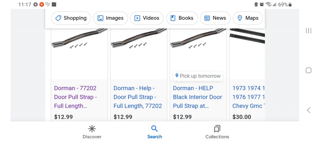

Found this, might be a great substitute but I'm not sure if it fits:

Have you looked at dorman 72202?
