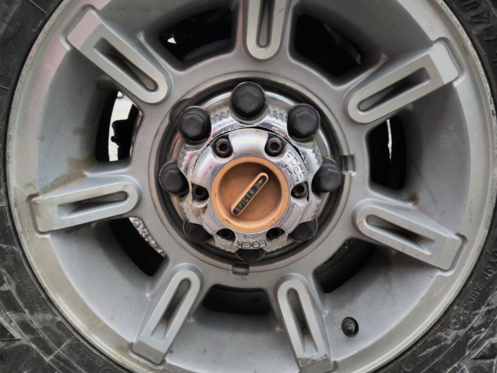

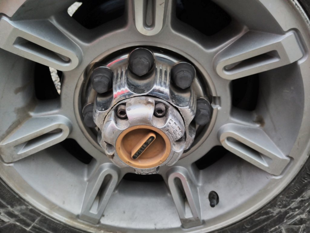

Got my center caps cut and installed on H2 wheels..yall like em? I'm indifferent about the look.. complete new drag link installed and 1" tie rods are waiting on the bench for warmer weather. Now I have locking hubs to chase down. Have the D44 up front but have the larger spicer locking hub? Think this axle came out of a one ton even though it's a 44..I've read that some 1 tons came with the D44 and larger spicer, in early years?

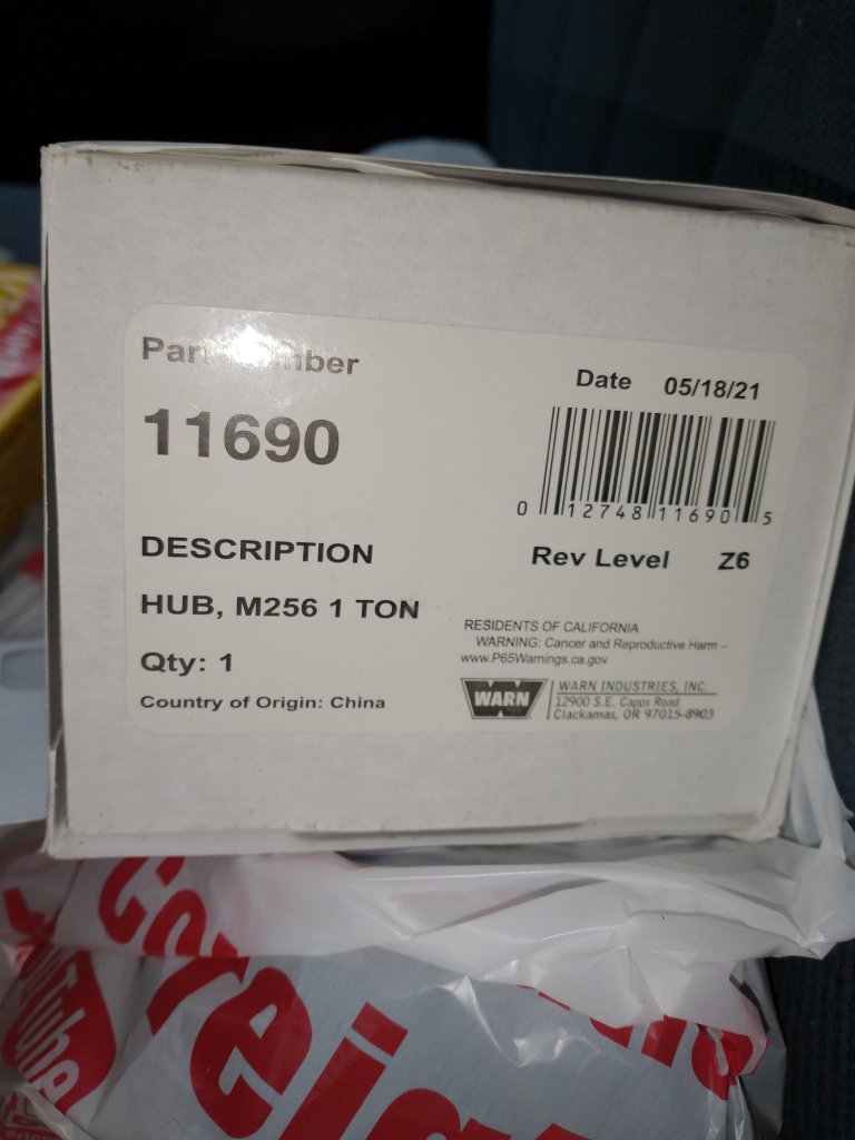

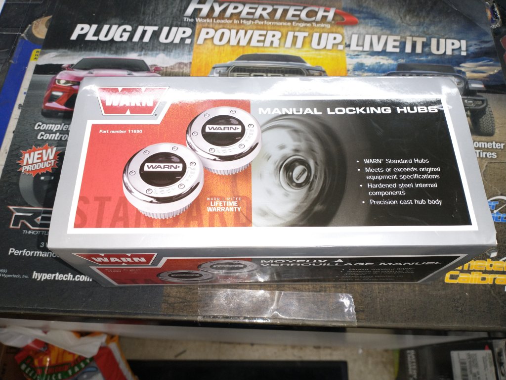

I accidently ordered these for a dana60, they are 30spline and I bought 35 spline axles, these are sitting on my parts shelf, if these will work for you I would sell them for what I paid for them.
they are way bigger than a corporate/dana 44 hub
I'm pretty sure those will work..doing some research those kept popping up. Ill pull them and count them tomorrow while I do my tie rods. Thanks for the heads up
Those look great! Seems H2 wheels always look unfinished since you never see them with hub caps.

I had the HD Dana44 a couple years ago. The axle tube is a little bigger in diameter. The inner hub bearing is a little bigger. Those locking hubs are called external locking hubs. The other common ones are called internal. I’m not sure about yours but my dana44 was still compatible with all other dana44/10 bolt axles not dana60s. I’m almost certain those warn hubs for a 60 will not work with your application. I bought the warm 9072 hubs.
https://www.amazon.com/dp/B000CQBMQS/
I’m pretty sure these are what you need. Hope that helps
