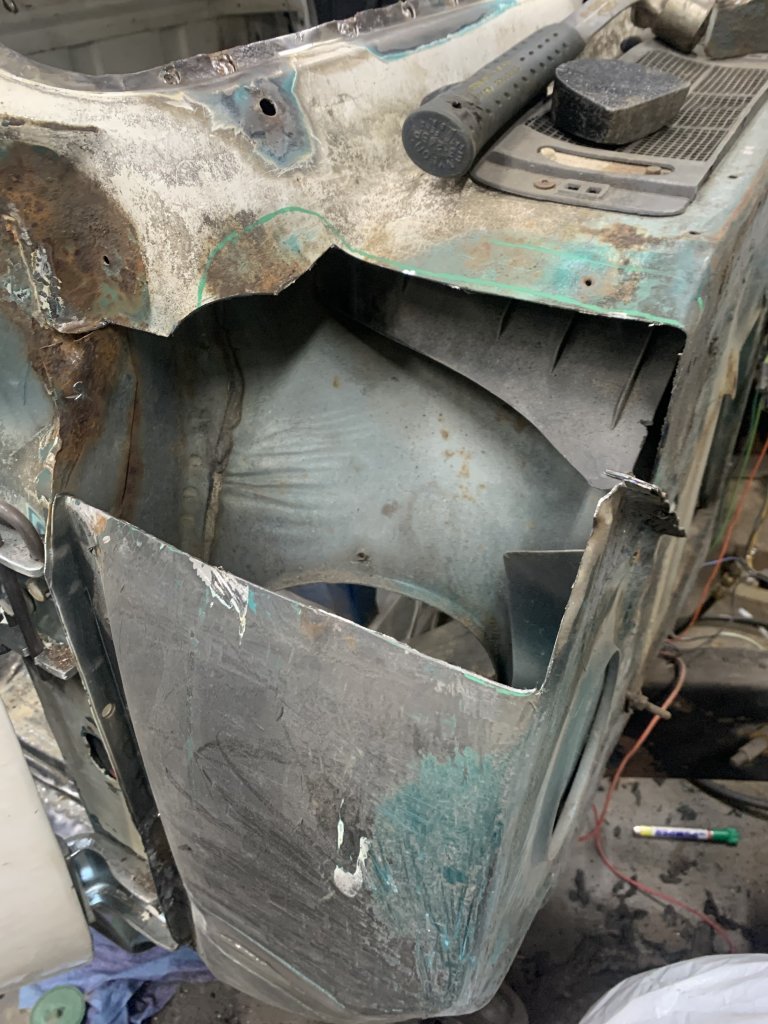

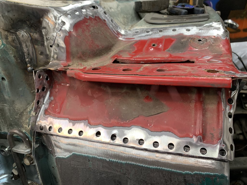

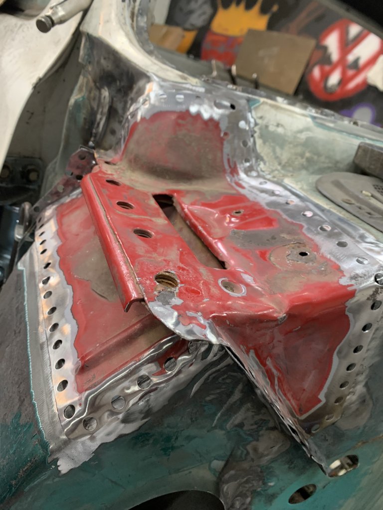

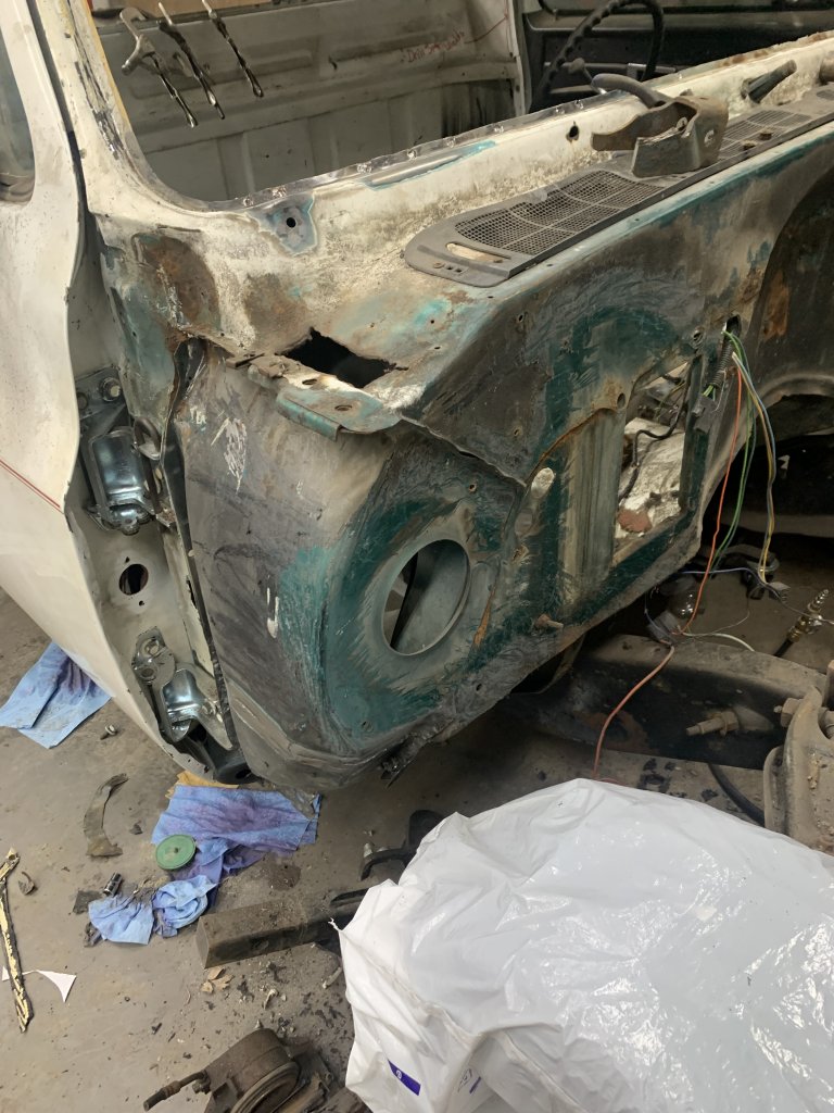

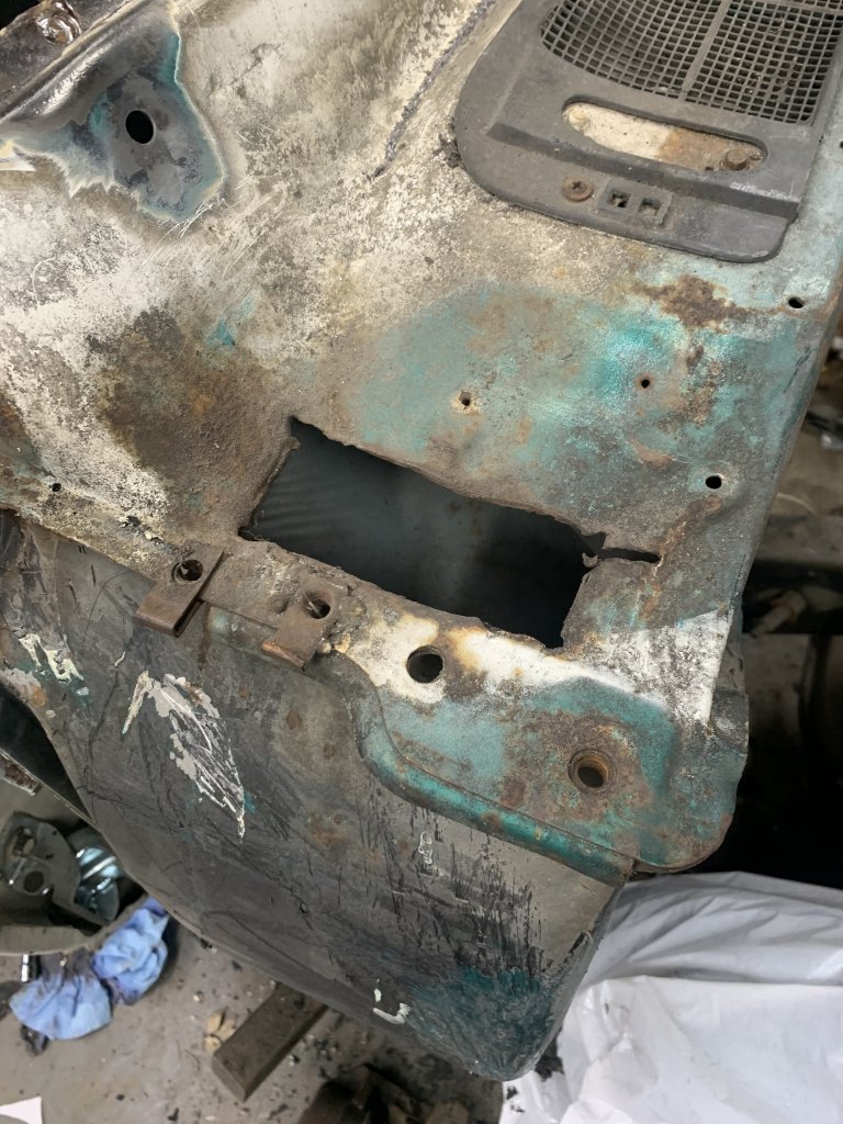

Updating the 79 to an 81-87 by modifying the upper front cab corners and putting patch panels in from an 85 instead of dads hack job from 20 years that cut into bracing - ******* old man theory 60feet or 60miles no one can tell the difference lol

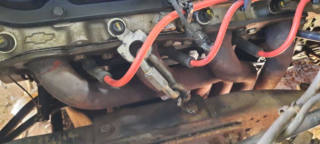

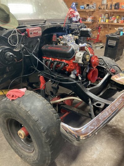

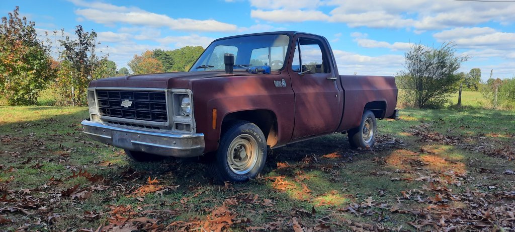

Well, today, I fabbed up some bracketry on my c10, to chain the drivers side of the motor down so the sob would quit twisting so much when I laid on it. Now the body and frame is all flexy when I stand on it lol

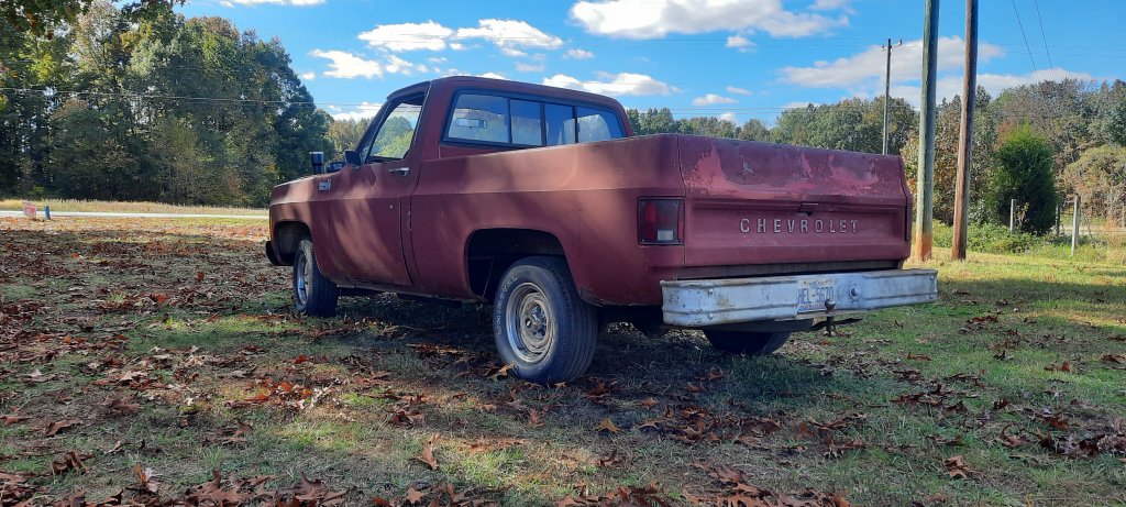

Following that, a while back I picked up beauty rings for free!
And maybe a month ago, I picked up center caps for I think 20$?
So today, I drilled and tapped the wheels to accommodate the center caps.
Looks decent.
Did a lil' tuning on the holley sniper, got it at a steady 13.5 or so AFR, nice rapid throttle response, and a reasonable 15 in/hg
Idles right, and returns back to idle after romping it. Still have some tuning to do, but does ok.
Also figured out why I had a battery drain, the alternator regulator was running constantly, I mistakenly hooked up a constant 12v to the alternator wire... I must admit, my mistake in this is, the harness is the original 1979 harness, and I'm running serpentine drive, so the alternator is a little newer generation, so I had to do a little cutting and splicing.
Either way, I got it corrected, thanks @bucket For the alternator diagram
On the todo list is to wire up a momentary switch for the kickdown of the th400, straighten up the interior, put the dash back together, and hideaway the holley sniper LCD screen back in the ash tray so from the outside it looks like a mostly stock 79, (folded hood and all)
I do wanna install some of those cool halo ring headlights , but we'll get there.
Edit: yes, the headers are bolted down, the actual primary protrudes slightly from the mounting flange
No leaks.

Do they make solid motor mounts for that???

Probably.... but that motor was interestingly EXTREMELY hard to get bolted into the frame, I had use a prybar on 1 motor mount and pick the side up, and stand (literally, stand) on the the drivers side of the motor to get the other bolt to go thru.
Unlikely I'm taking it back out until I explode it.... which after that, it'll get a blower and some bigger heads.
So for now, redneck chain it is.

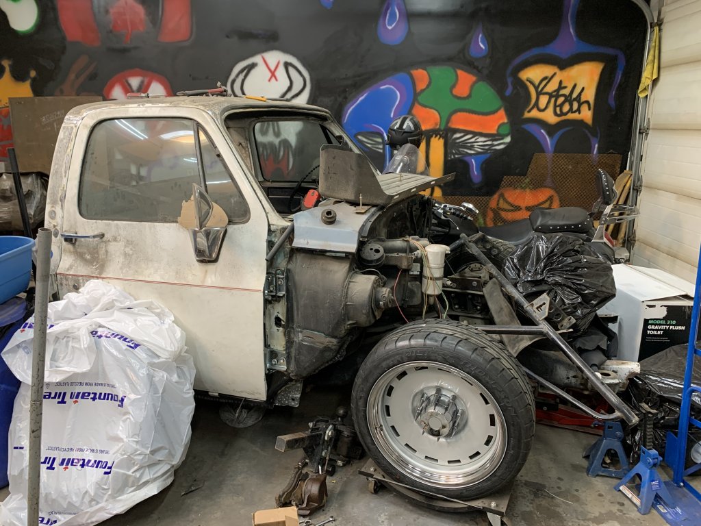

Jacked up, lined up, and bolted together all the body panels on the front of my 78/85 k10/20, so I can see what I'm working with and to lift the sprits a bit. Hasn't looked even have way like a truck on quite a long time. Starting to look like something. Hopefully I can get the cab on before winter.
Its fitting that I gave "Frankenstein" a face on Halloween eve, haha.
Also gutted and cleaned out a set of doors a guy here in town wants to buy.

And the 79? No, it's gonna live it life a complete shitbox that's butt ass ugly with a rolled on burgundy paint and bent hood
