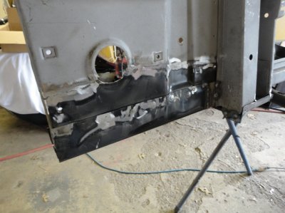

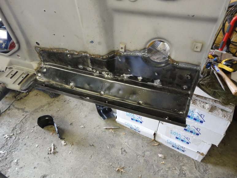

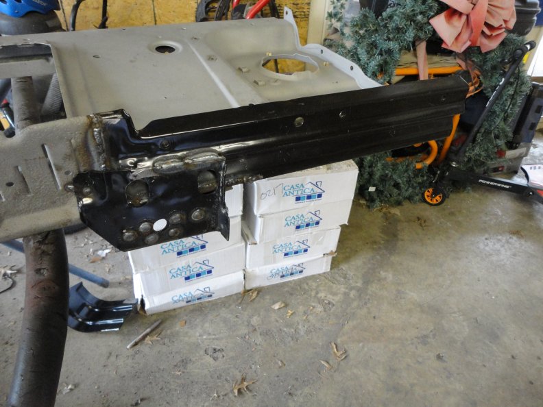

Fixed the radiator core support for my 73 GMC C25....the lower passenger side was rotten. I cut out "patch panels" from a repro core support and fit them in my original. Smooth the welds a little filler and its ready for epoxy primer!
