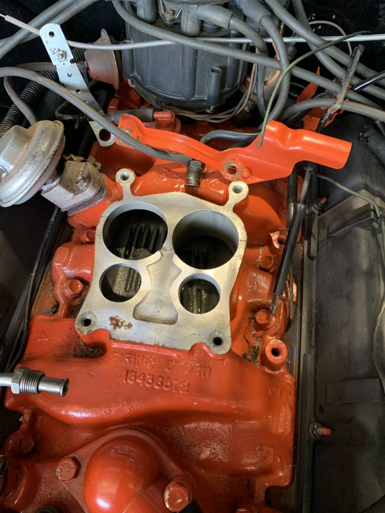

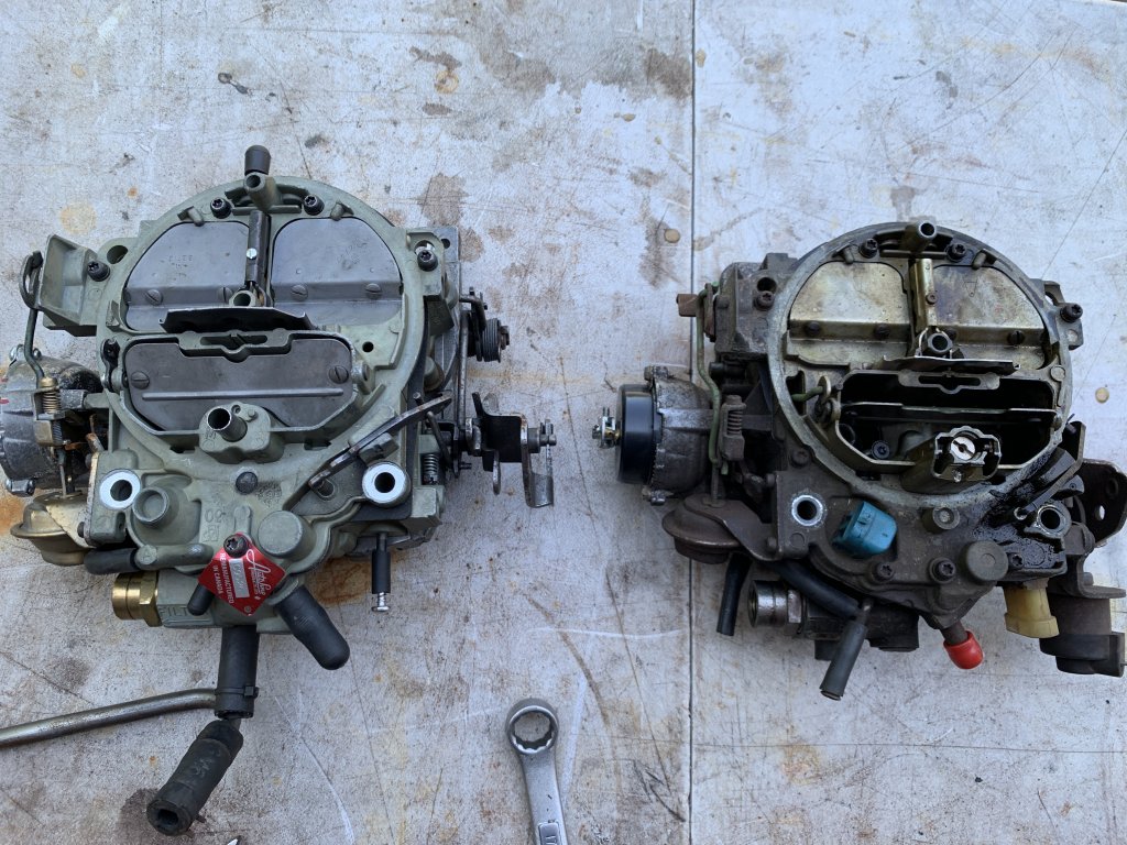

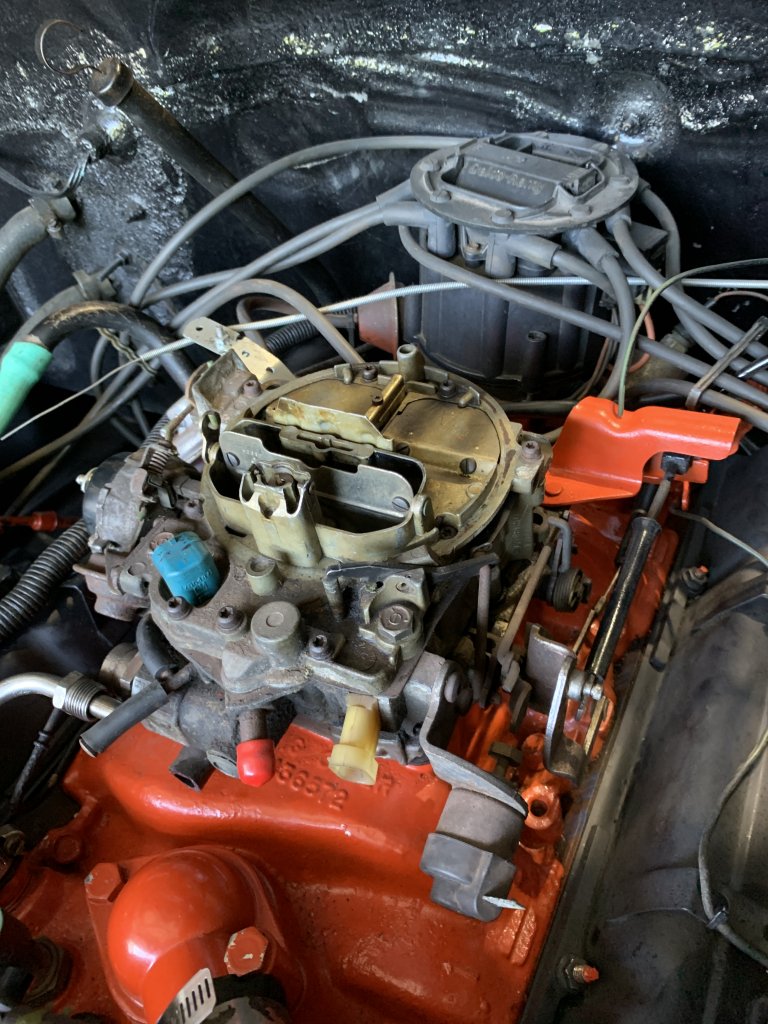

The list of things I have found wrong with this truck since it's purchase last fall is long. But I wanted something to get me off the couch and out in the garage and it has certainly accomplished that goal.
This is my first older truck and I have a lot to learn. Many of these issues would have certainly been caught before purchase by more experienced people, but you have to learn somehow and it is satisfying to get some of them sorted, the truck running better and learn in the process.
The truck always started and ran fine. Maybe seemed a little rich but no stumbles or obvious issues when taking it for a drive. I was occupied all winter with rebuilding the rear end and other issues and never really looked too close under the hood until June when it was finally licensed for the road.
I knew the engine was changed a few years ago. When I started investigating what carb was on it I discovered it had one of the electronic carbs, but my truck doesn't have any of the electronics control stuff. Everything I have read says my truck shouldn't run and it's impossible to run this carb on a normal truck without the control gear.
It did run fine, but probably way rich so I looked around and found a recently rebuilt normal Rochester.
The oil pressure switch near the distributor is the one wire type so I had to find another keyed power source for the electric choke. I used a wire off the wiper motor and it seems to work fine.
The old carb base gasket was in poor shape, but the install went better than I expected and in a few hours the truck was back running. The replacement carb was setup for a 350 but it seems to run fine on my 305. After running it a bit I will probably investigate what changes should be made if any.
Next week I'm sure there will be something else to deal with.
