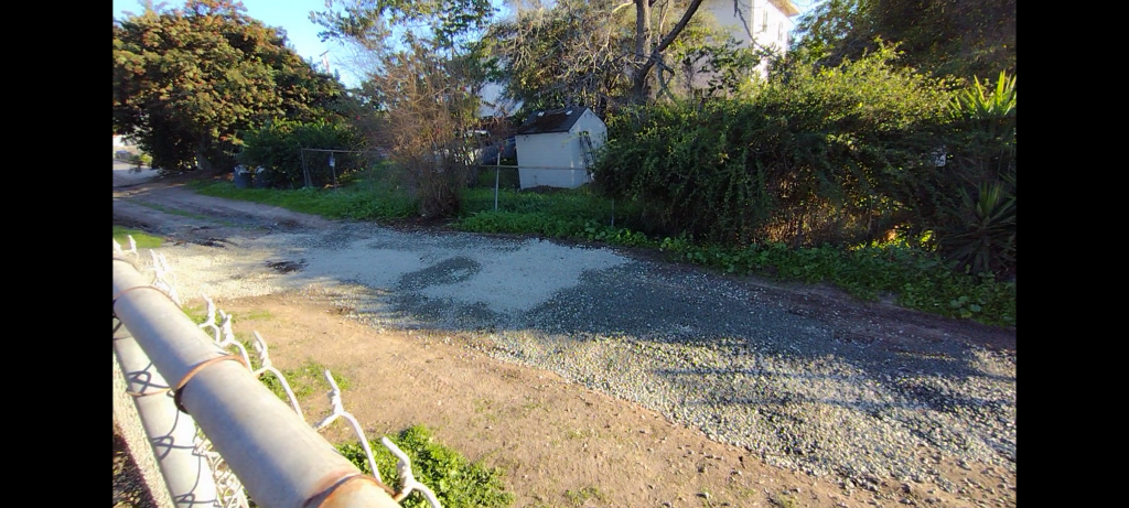

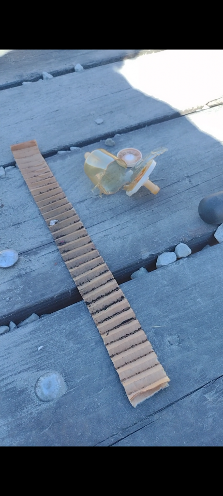

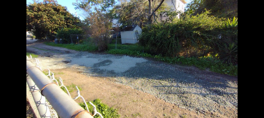

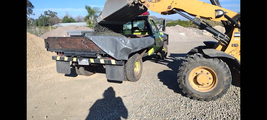

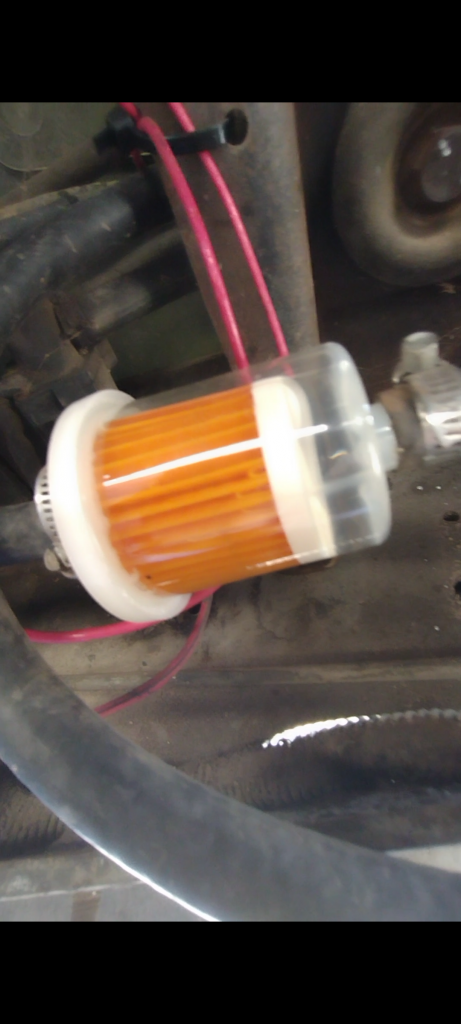

Few weeks ago I pulled the sending unit and deleted the fuel tank sock some debris were left in the tank it ended up clogging the fuel filter right before the lift pump and truck died while I was hauling some rock made it back to the house swapped filters and made a second trip few more loads should help keep the clay from getting tore up from all the rain we have been getting it got bad enough that I could no longer get a car in the back lot for repairs
