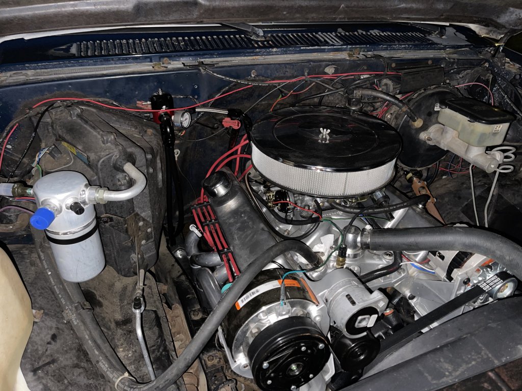

I just finished up on the many upgrades and I finally started it up the other day.
Turned key to ignition, checked for fuel leaks and get fuel pressure instantly.
Cranked on first try. No pumping the gas pedal and you would think its fuel injected. (I never experienced a carbed motor like this truly in awe!)
New gas tank w Aeromotive in tank electric fuel pump, all new braided ptfe hoses with return line.
Aeromotive regulator & inline fuel filter along with their relay and all wiring.
This feeds my new Edelbrock AVS 2 carb.

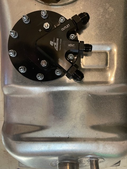

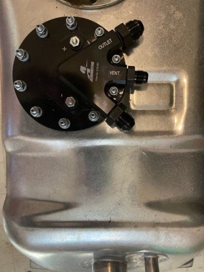

They have a tank setup for earlier square bodies ready to go but the tank filler is different on earlier model. I bought a new tank and drilled a hole in the top for the Stealth system fuel pump system. Uses stock fuel sender with plugged fuel outlets.
I had to clearance a channel under the bed a little.
Also installed new Flowmaster exhaust with Doug's headers and new GM serpentine belt drive.

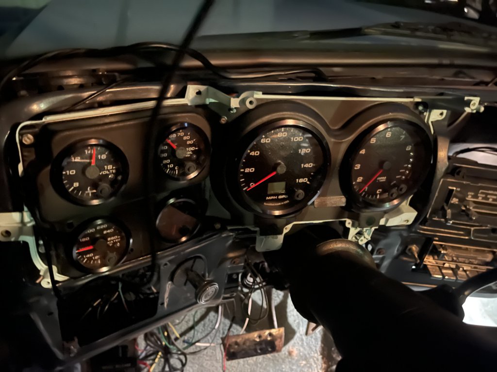

Oh and got the new Speedhut gauges installed. I love the tach!

Still need tidy up a bit and install new gauge bezel and dash pad.

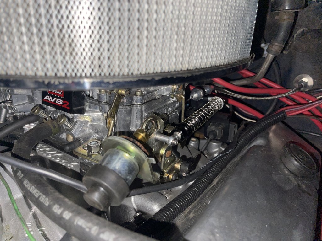

The new throttle assembly from Hotrod Innovations and Lokar cable rocks!
