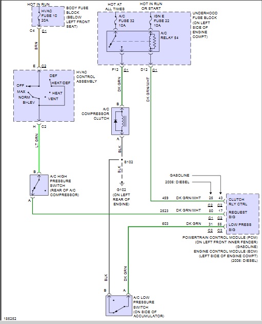

How did you wire them? Looks like you are running an L31 with an 0411 conversion? Did you wire them with the three relays like a stock 2007+ silverado? The stock three relay system runs both fans for both high and low speed, but low speed runs the fans in series and high speed has them running parallel.
That is correct. My PCM is running the express van OS and “thinks” it has control of the AC as well. AC on forced low speed, the. I use a trinary switch to hit high speed if needed. No segment swapping, or other foolery.
So you are running the 2156 OS? AC recirc set to Fan #2? So when AC is on, the ECU turns on low speed fan. Have you ever had the trinary switch trigger the high speed? Seems like my truck gets plenty of airflow at low speed to keep the AC pressure plenty low, even when it is super hot outside.

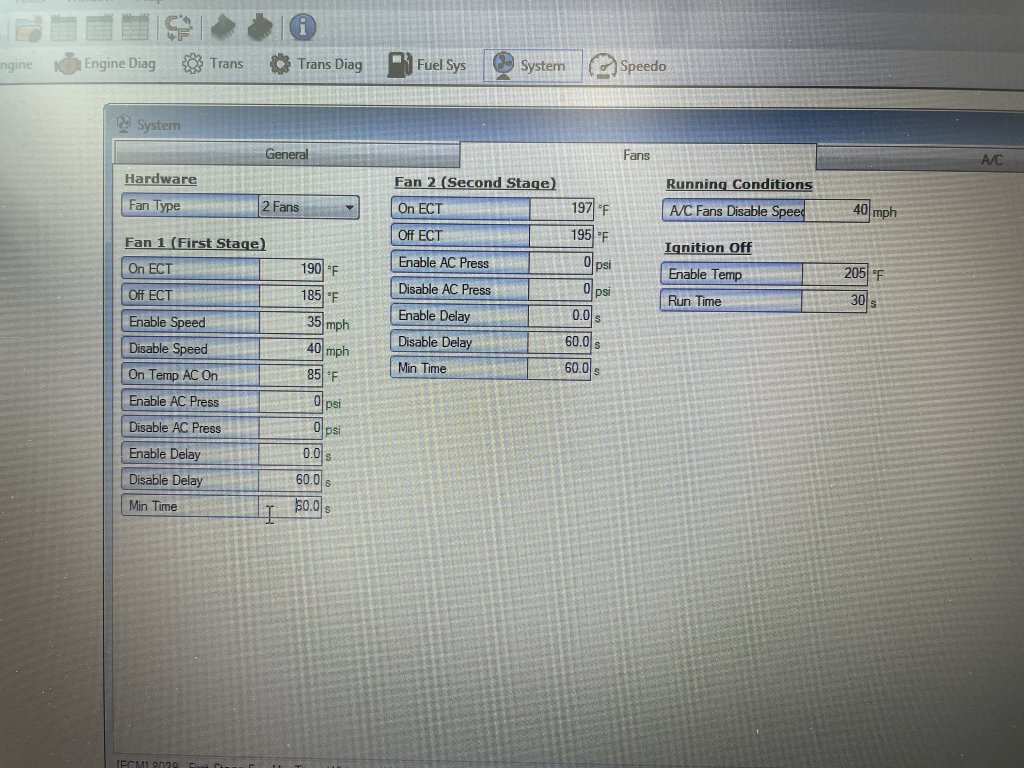

The few times I’ve noticed the fans running on high, it was due to coolant temp as I have them set a little low.
I’m not sure of the OS number but yes, recirc is set to fan 2 and I had to change the AC type to “something” cycling, then add a few pins.
C2 - 17 - AC Request DI. Blue
C2 - 55 - Low Pressure Cutout. Green
C1 - 42 - #1 Fan DO. Brown
C2 - 33 - #2 Fan DO. White
AC Request is tapped into the clutch positive.
Low pressure cutout, I just grounded it since my trinary is on the + side of the clutch. Look at the schematic and you’ll see the cycle switch “should” be on the negative side of the clutch. My PCM only “thinks” it has control of the clutch.
Don’t mind the colors, that’s just for my ref because I ran a bundle of wires from my pcm to the relay box.
DI means Discrete Input to the PCM
DO means Discrete Output from the PCM
Also notice I lowered the “On Temp AC On” for fan 1. I wanted the fans to run basically anytime the AC was on. 86 was an arbitrary number. I forgot about defrost so went back and lowered this to min value. I think it was zero.
