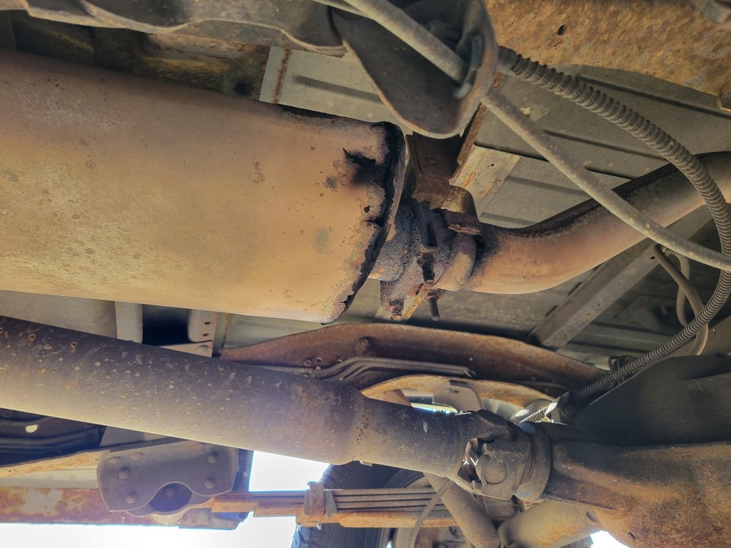

Spent time Friday pulling what was left of the exhaust off the 'burb. Going to temporarily throw a standard replacement muffler and tailpipe on there until I can get a better understanding of the condition of the motor, as well as one of those slimline flexible 'catalytic converters'. It did seem to run better with all that junk removed but not sure the neighbours agree.
Got to looking around underneath while at it and found that the panels behind the bumper are pretty rough. I find the pattern of corrosion on this thing pretty strange as the frame rails are a bit scaly but the underside of the body has a lot of paint and very limited surface rust. That said it does look like most of the paint came out of can. During a dust storm.
