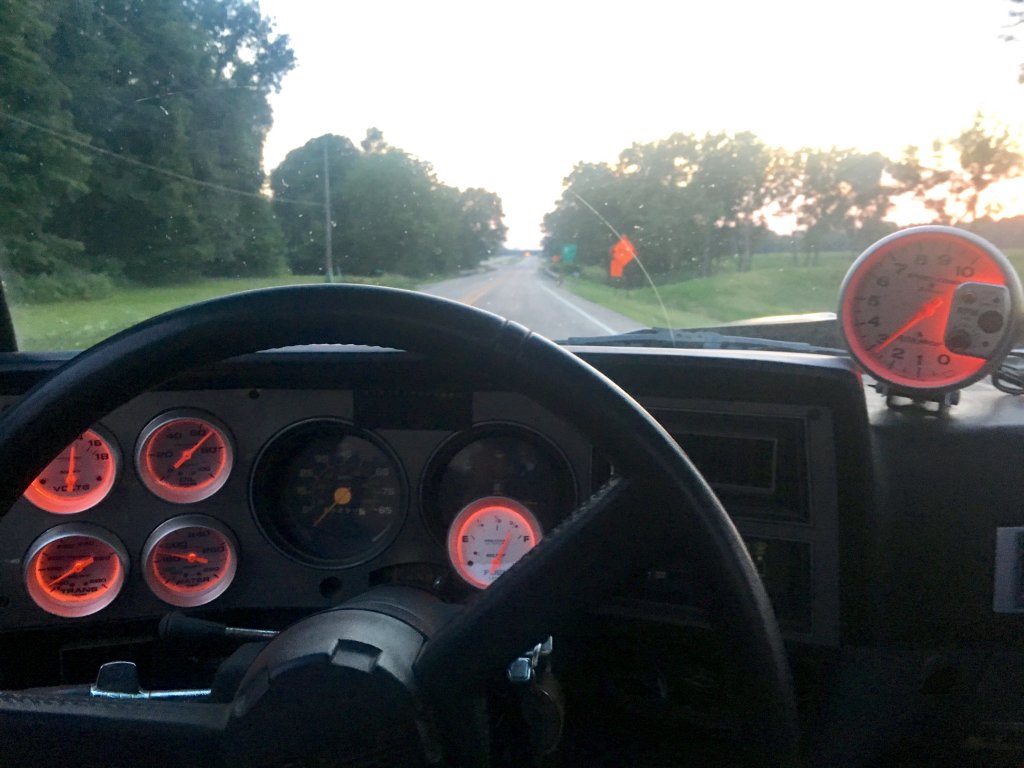

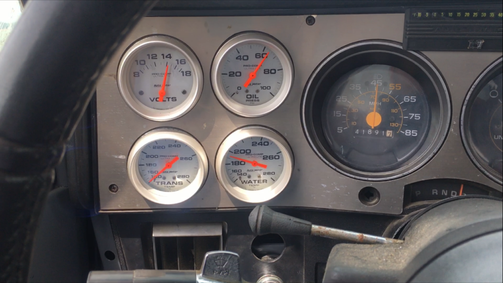

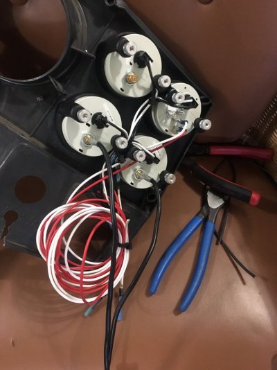

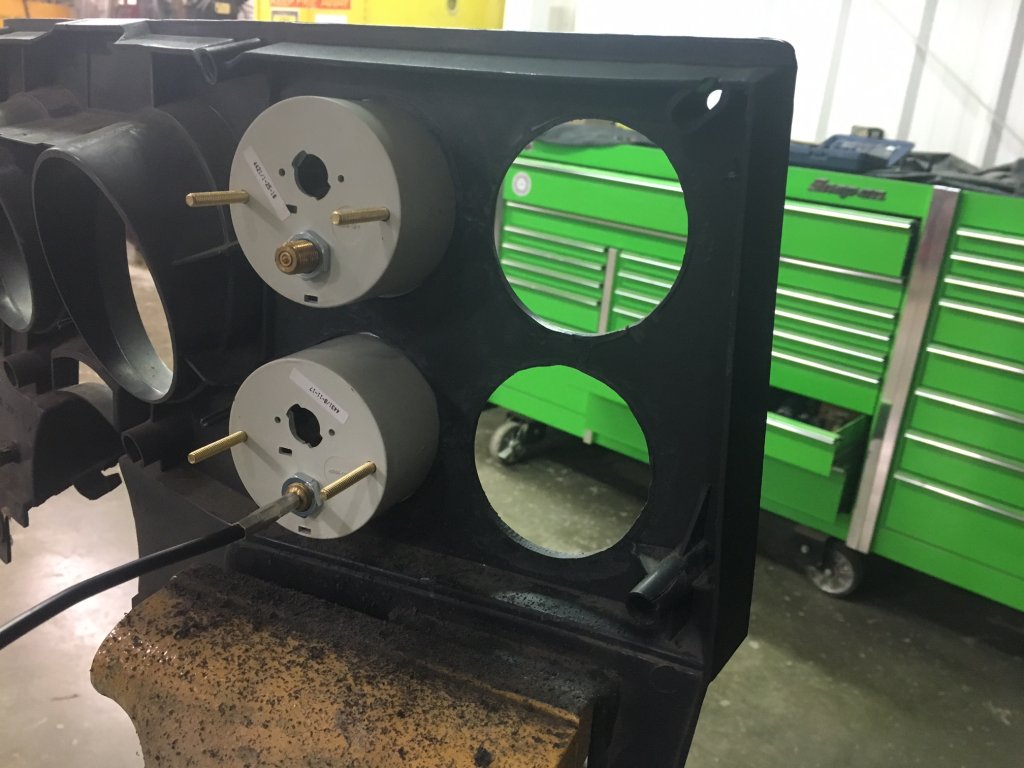

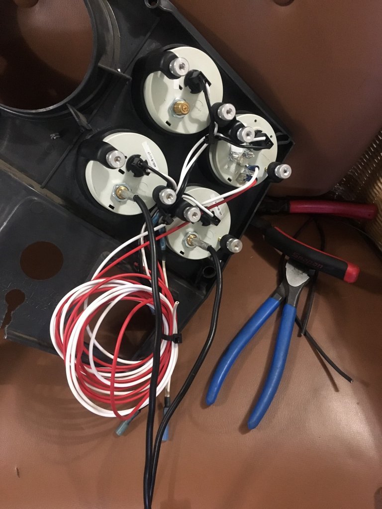

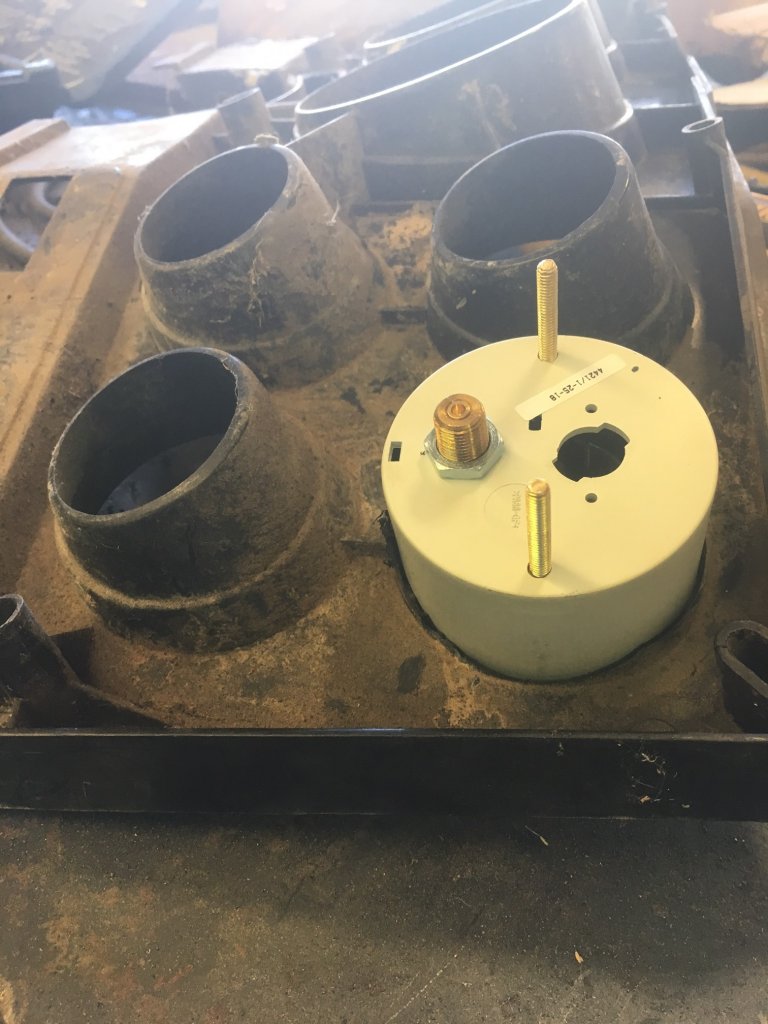

I used 2 5/8" autometer gauges on mine, used an appropriate hole saw to drill the tubes off the bezel and a deburring tool to fine tune the hole sizes and as stated above if you're going in, it can get pretty invasive. But I plan to make a complete custom faceplate for my dash and completely rid it of the rest of the factory gauges at some point so it didn't bother me to "cut" it up. I had an old bezel that I used for mock up before cutting up the one in the truck just to make sure everything would fit with the 2 5/8" gauges and once I determined it would I took to working on the one from the truck. I'm ok with how it currently sits at this point.

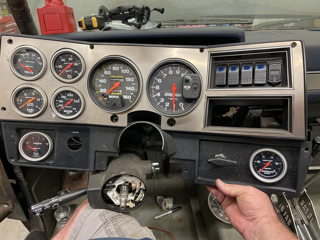

Fwiw, this is my set up - 2-5/8” small gauges and 5” big gauges. My dash is completely gutted so there’s nothing behind the bezel for interference. I also found some black textured plastic sheet at Lowe’s or Home Depot (can’t remember) to make a couple of block off plates for additional gauges. I bought a switch panel off of Amazon that coincidentally perfectly in the vent spot at the top right.
