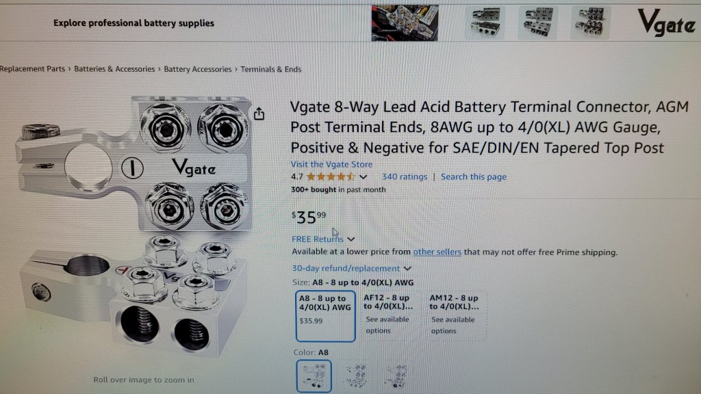

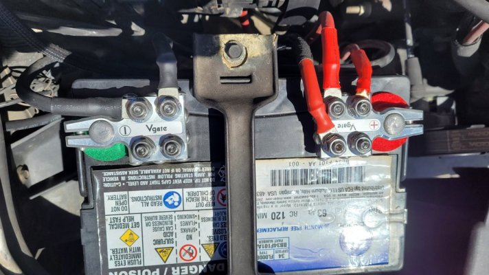

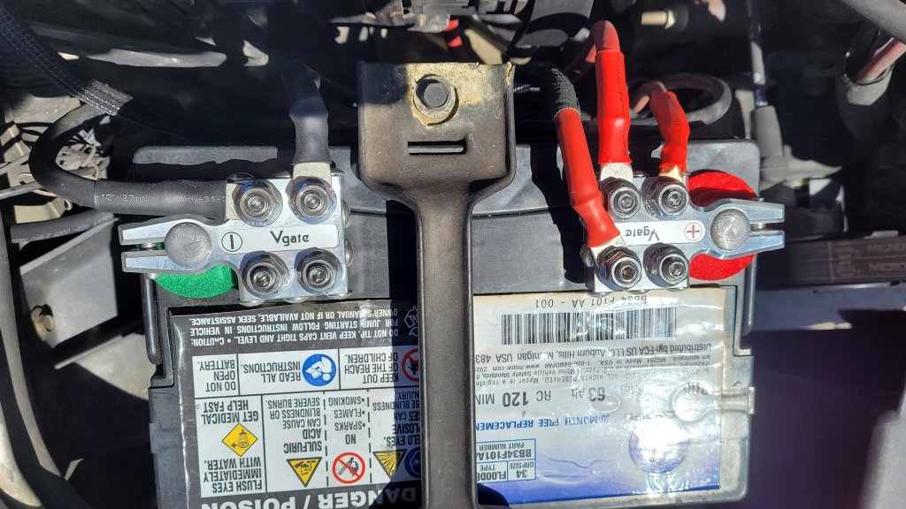

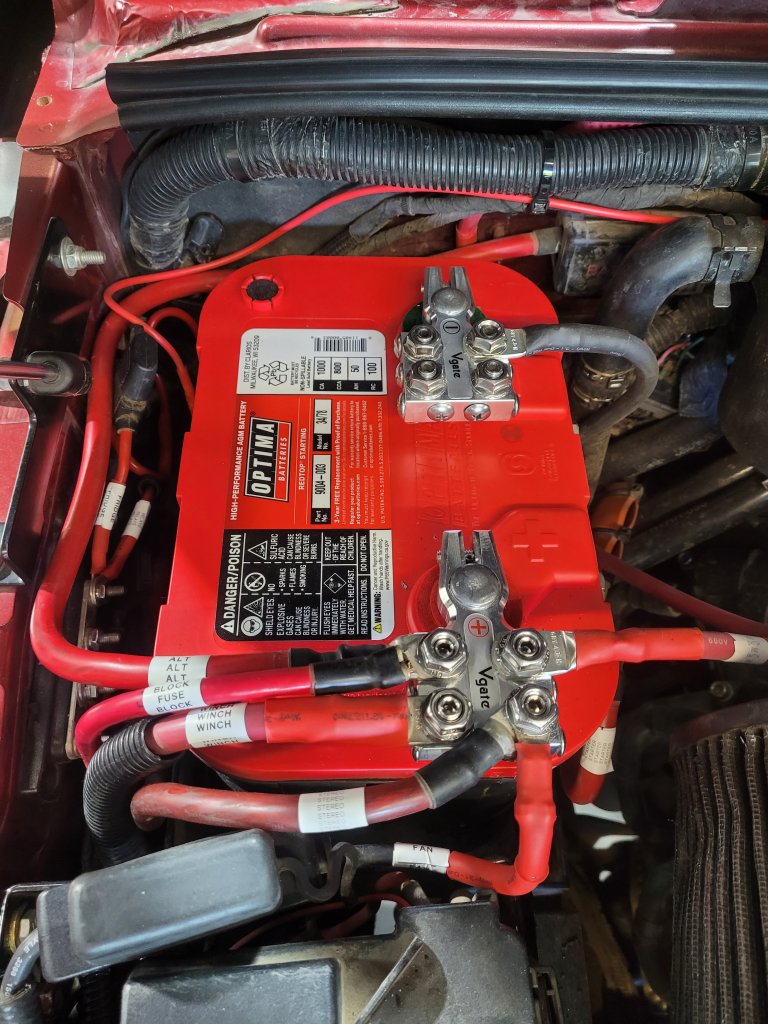

Tackle it ONE wire at a time, so it's not overwhelming. Like the guy above said probably not going to fix the power drain, but still worth fixing to reduce later problems.
I have used these on 3 different vehicles and rate them highly. They come in different configurations with different types of connections. I would have gone with the version that takes the wires directly with a set screw to secure them. The more connections you can eliminate the better.
I spent a lot of time debating this with clients.(Been an A/V contractor for 48 years) They wanted pretty wall plates with all the speaker connectors in nice neat rows, because to them it looked professional. Then I would ask them if they thought cutting their garden hose in to several pieces and then splicing it back together with high quality connectors would make it work or look better. Same thing with wires, it's never a good idea to add more connections than necessary to ANYTHING.
The correct size crimp-on connectors with a real crimp tool is essential to reducing your electrical problem instead of making them worse. Whoever did your larger connectors just squashed them instead of crimping them, which usually creates resistance and heat, instead of a good solid connection that lasts.
Also it looks like your ground from battery to radiator support is under sized, especially if you have a stereo/sub amp.
