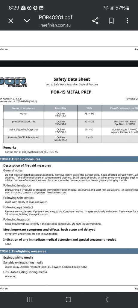

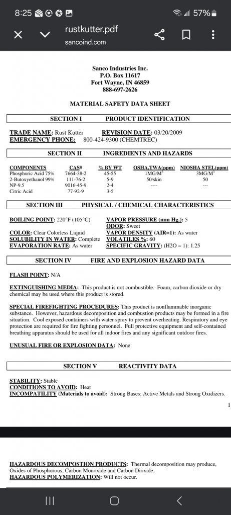

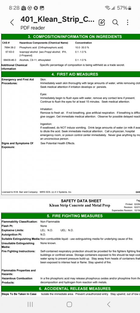

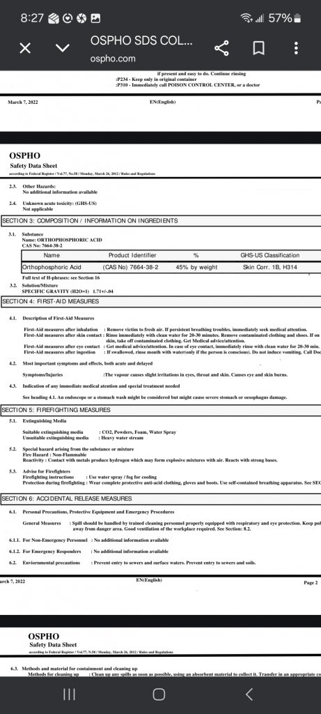

When you get down to the rust, spray it with Rust Cutter and leave overnight. Wipe it away with wet rags and dry, You will have nice clean metal ready to primer.
10,175
19,672
Just for fun I pulled msds on por15 metal ready prep. Ospho,Kleen Strip,and Rust Cutter. They are all phosphoric acid. Which turns rust into iron phosphate. Again it's tge magic prep not the magic paint like POR wants you to believe.
