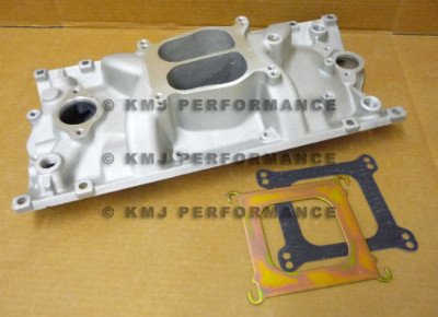

Havin a hard time finding an intake without the the two middle bolt holes.

Those all have the two holes im talking about, they are on only one side of the intake and next to the carb ports. Are they just bolt holes I dont need to use?

are you talking about the duel mounting holes for the carb

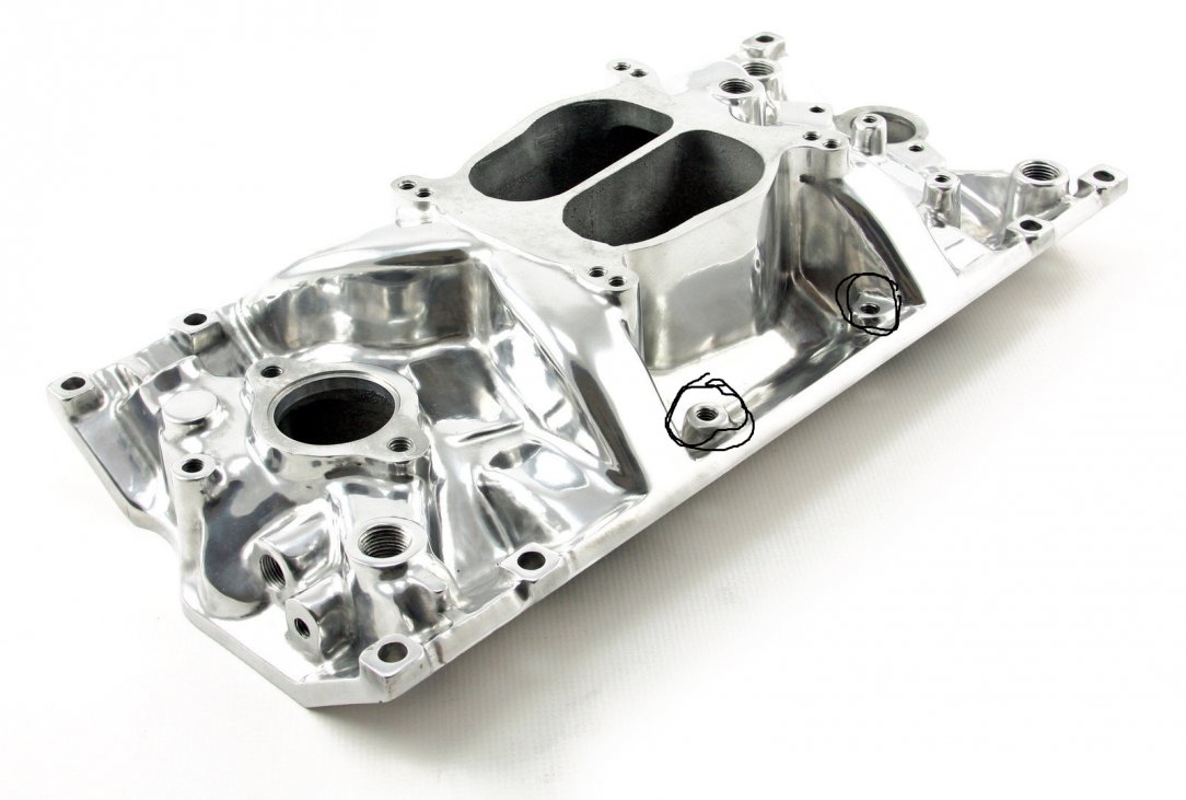

These two bolt holes

if I am thinking correct those are for air conditioning brackets

Yes they are for ac. Accepts the rear bracket for an A6 compressor. Rarely used these days.

WOOT! awesome, so can I assume this will bolt down fine?
