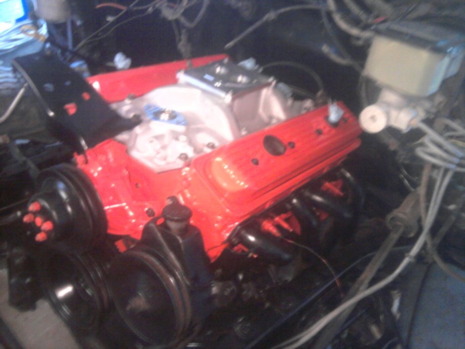

a vortec is a factory roller cam motor you can get the ht383 cam and run stock roller lifters.
the ht383 cam is not a monster cam it should run good
and you can get a 383 crank and make it a 383
the gm performance parts ht 383 is rated at
•Horsepower: 340 at 4500 RPM
•Torque: 435 ft/lbs at 4000 RPM
I had a vortec 350 rebuilt at a local machine shop and I had him copy the ht 383 specs
and the vortec heads would be a lot better you can get cheap carb intakes on ebay. I think they are pro comp intakes I bought one good quality.
the motor pictured is a 99 vortec 350 with a old metal timing chain cover and the carb intake
