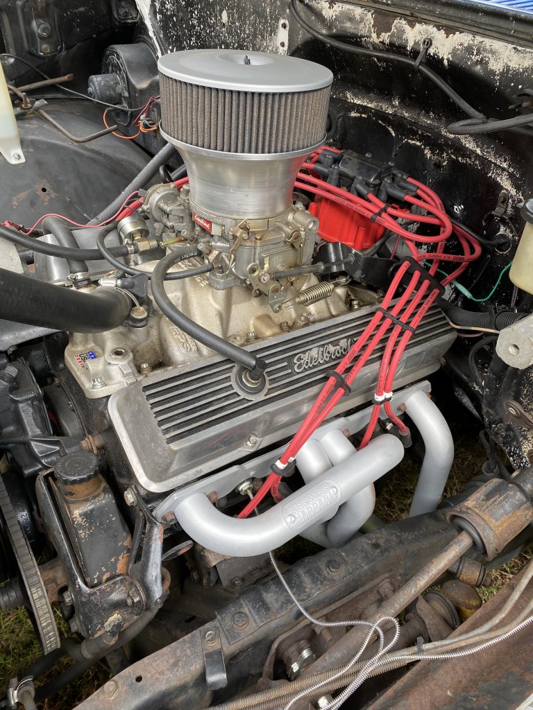

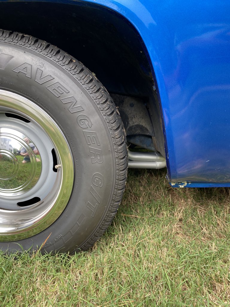

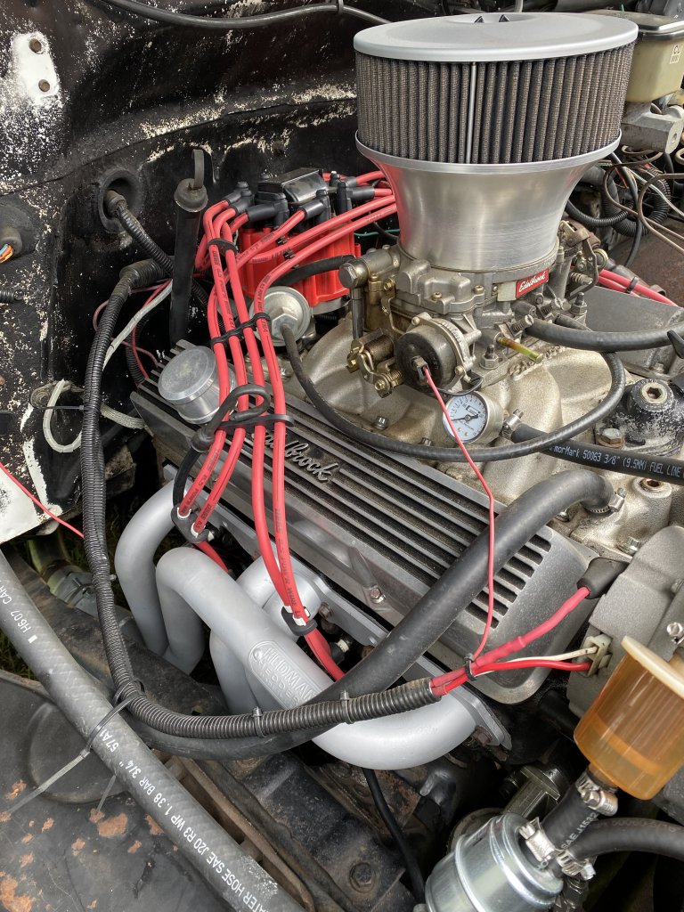

This may help anyone who’s wondering if the header coating really works. I bought new Hedman’s and bead blasted them. Following VHT’s instructions and testing my patience…I’m really pleased with the results. It’s been three months and maybe 500 miles. Hell, maybe you guys already knew this but I was skeptical.
