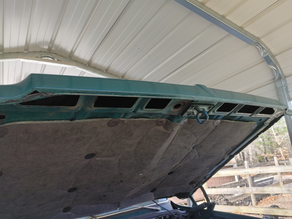

Not sure if this is where I need to post. A little friend decided that they would build a nest in my hood latch area and use my new fiberglass Hood insulation as bedding. can anyone tell me if they have seen or no or can suggest how to cover these holes so the Little Critters can't get in. Thanks

What kind of critter was it? You could cut some light sheet metal or plastic sheet, to fit inside the recessed areas or just a long strip over the whole side and screw it on with little self drilling screws. Something like that.

Pouch them in cheesecloth and zip tie the pouches under the hood. Doesn't necessarily have to be in the hood. Could also stuff the holes with steel wool. I have done that with mouse holes then filled with expanding foam spray. They won't chew threw that combo.

It would be good if you could get an idea what the critter is, here the main things are mice, rats, and squirrels. Squirrel here are not to much of a nuisance they will get into feed and sometimes automobiles outside, but generally don't get into houses at least not here. And they aren't hard to keep out. The moth ball / steel wool trick is probably your best defense in that case.
But if it's mice and you try to block them from under the hood the next thing you know they might go down the heater duct. If it's rats that's bad news because they are just so destructive and hard to get rid of once you have them.
I would really encourage you to try to figure out what the critter is. If you think it's mice set some traps under the hood. You might just prevent them from getting into your house next.
I live on a farm and it's a constant battle with mice and rats. If I wasn't proactive with trapping, (I've got animals so I can't use poison) They'd be into everything I'm sure.
I just don't want to see you bandaid a larger problem by just keeping them out of the truck. Good luck however you choose to handle it.

The ideas about putting something to cover the hood access will only relocate them. On my son's truck they climbed onto the air filter and chewed up the hood blanket from the engine side to acquire the building materials they needed.
Kind of like the professional free range campers, if they steal your gas and you put on a locking gas cap. It does not stop them, it just makes them move to another vehicle.

Right that's my point exactly, don't want to relocate them. Next thing a guy knows there isn't an issue in hood insulation anymore but they are in the air cleaner or go down into the heater and create a truly awful smell in the cab.

Fairly certain it was a mouse. Nest not that big. Never had a mouse build a nest there before. I will just have to be more proactive and go out and disturb them more. I have been a very bad owner. Haven't been out and messing around the truck much over winter. Of course the little F***er decided to use my brand new hood insulation pad for nesting material AND has some shells between the mat and the hood. Removing the liner tomorrow and looking into spraying Boom Mat on underside of hood so nothing to use for bedding.
