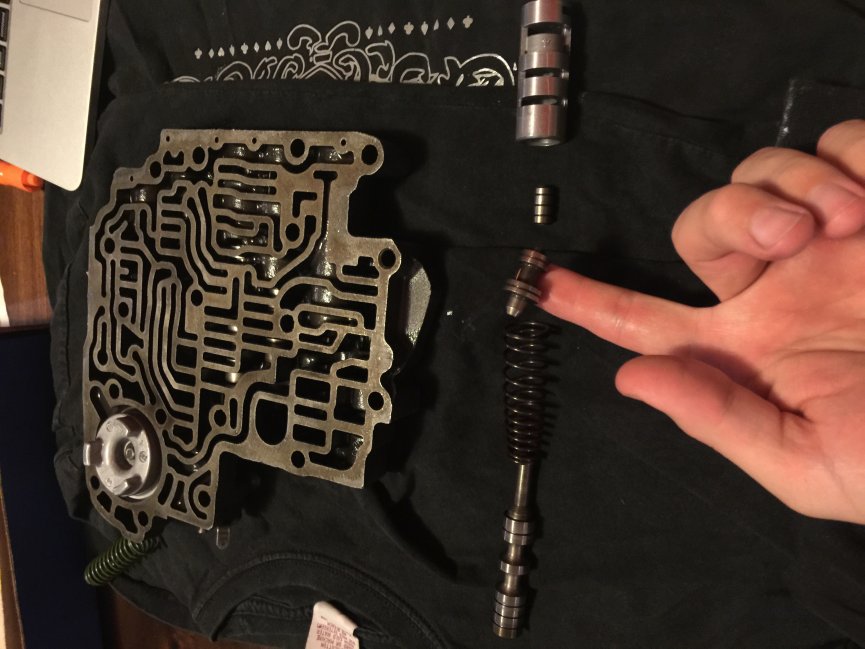

First, i have a th-350c and have installed a transgo shift kit. My reverse was acting up. When i put it in reverse it would bog the engine then studder and die. But the forward gears worked perfect.
So i dropped the valve body to find the little piece (reverse boost valve) had slipped out of the aluminum boost valve sleeve and was slideing back and forth freely in the valve body cylinder. My question is, is it supposed to stay in the sleeve? And how? It seems that nothing is to stop it from moving around.

Fixed It!!!! It was the small reverse boost valve in the pic afterakk. I installed it correctly with the orange spring in the pressure regulator cylinder from the transgo kit and it working great!
