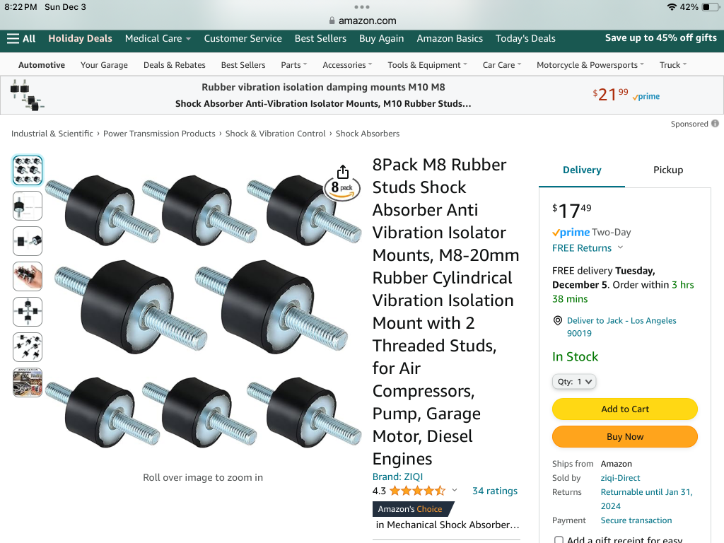

don't know what they are called, but there are screw in rubber bushings of different sizes.
rubber spacer

Great idea!
i think this is what CamarO68 is talking about

Is this the size I need for the factory roof rack rivets? I have the rivets on the roof still but I think the previous owner put silicone in them so there’s that lol

The ones shown are metric so i would say no.
I would think maybe a 1/4 20, best test fit first.
The last thing you want is for those riv-nuts to start turning on you, then the headliner has to come down! Anyway, I recommend using a thread chaser first, good luck
