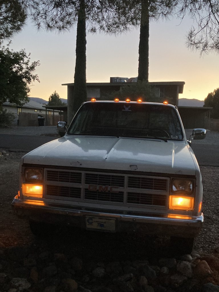

Update: Went to my local auto electric shop and he told me to use a butt connector on the end, then strip some of the coating from the feeder wire where the lights are. Did that, wrapped the light wire around the stripped feeder wire and taped them as he said. Got them hooked up and working. Got rid of the "Scotchlocks" or whatever those things are called,

I've always thought cab lights were a nice touch. Looks good!
