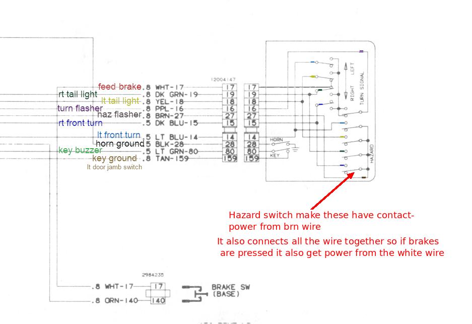

What I would do- Since you have checked the fuse and flasher relay, I would check the connection at the turn signal connector and also see if I had voltage on the brown wire there. It is knee level on steering column. If you have voltage there, I would personally just put in a new turn signal/ hazard switch.

Thanks SO much guys for all the help!
I checked and I do have constant 12v in the orange wire at the relay.
So it’s the signal from the switch that’s not getting to the relay.
Gonna get a switch and get it swapped out and take it from there.
Thanks again!!
