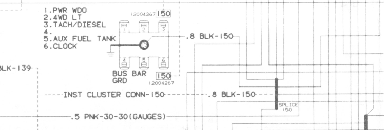

I noticed before when I looked under!behind the cluster, there's a set of what look like grounds but there's nothing hooked to them. Are they for extra accessories?
If you are talking about the prongs on the ground bus bar- Yes
