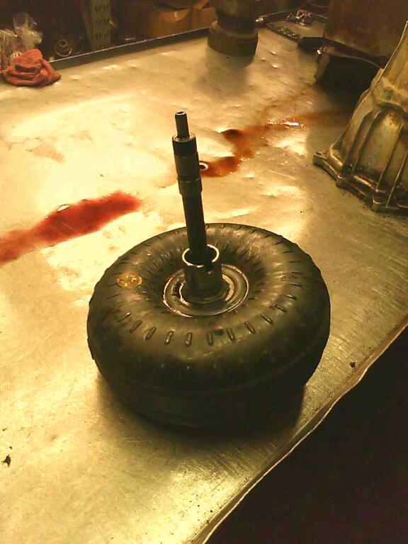

Here is the picture of the vibration source I had. The new tranny is woking out fine so far.

Input shaft seized into the TC? Never seen that one before.

c 10
Neither had I!! Don't understand how it was still driving but it was.
47,210
9,482
The input shaft teeth were obviously still engaged in the direct drum. Obviously very loose and didn't break the drum out, but at least made the hole bigger because that shaft is a press fit in the drum. It got big enough to not be a press fit but not so big the splines still connected. I'd throw that drum away ASAP so it doesn't get mixed in with known good parts. I never let bad parts sits around. They go straight to the scrap bin so they don't get used accidently or I look up on the shelf and think I have something in stock.

c 10
Yeah, it went in the junk bin. The front drum, input shaft and converter all got replaced. When rebuilding this thing I went ahead and put a transGo kit in it.
