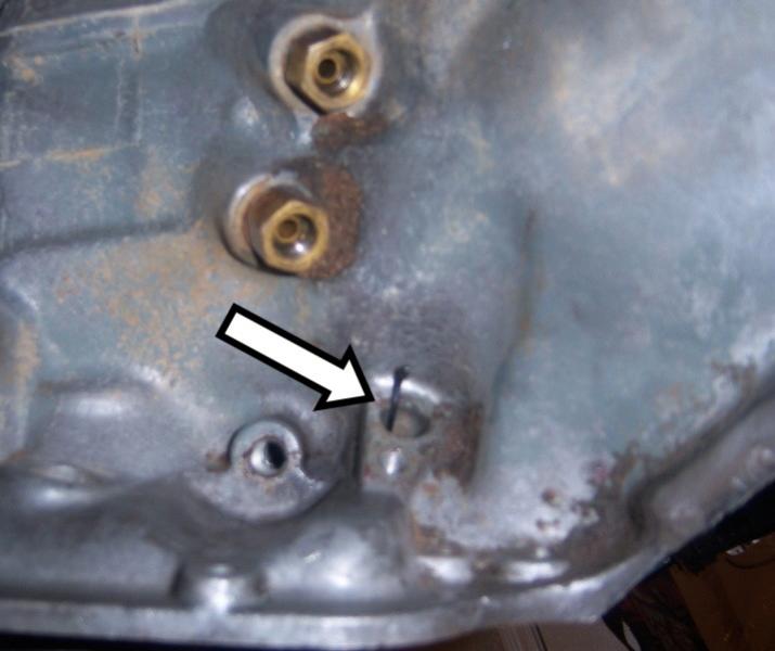

My kickdown cable to the t350 trans got broken off. I got a new cable but its just a little hole and i dont see were to hook the cable too????

Did the cable break off at the trans? Have you taken the bolt that holds the cable to trans off yet? Take that bolt off, take the rest of the cable housing off slowly. You should see where the cable is hooked to a wire that sticks out of the little whole. Let me know what you got or where you're at on this. I can get you some pics.
If the wire is there, you don't have to remove the pan. If its not, then you'll have to remove the pan to hook the wire. You trans will perfrom so much better with that cable hooked up.

there is nothing in the holw were the wire was. No hook. Just my luck. I got a new cable and put in the hole so I wont leak trans fluid. What do you think?
Well **** the bed Agnus !!! If you don't have the wire sticking out of the hole, then you'll need to drop the pan to install the wire on the linkage portion insdie the trans.

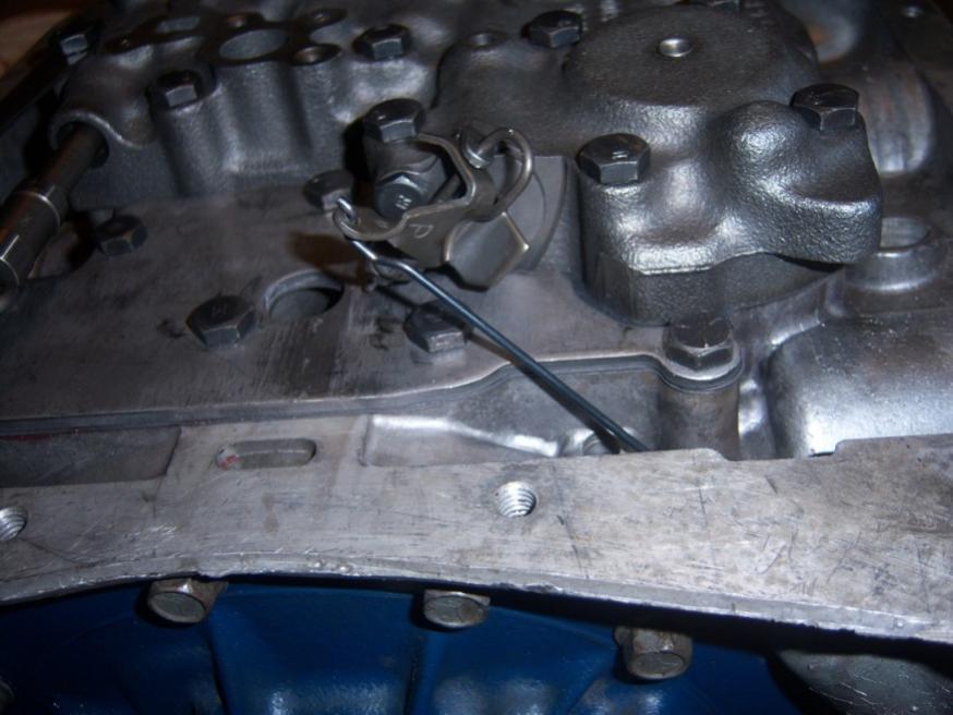

Man, That sucks. When I drop the pan, is it eazy to get to then?
47,935
11,198
That wire goes to the trans valve linkage inside the pan, then your cable hooks to the other side. Here is a pic of how its set up inside the pan. This was from a trans I was disassembling, so that's why its so dirty.

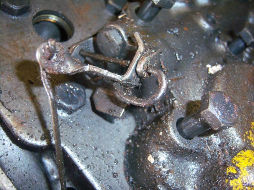

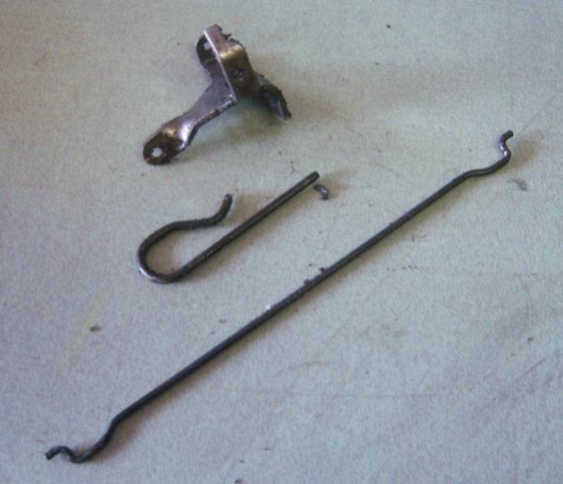

Aha, I fouund better pics.
Once you drop the pan, its right there. A piece of cake. Just a PITA that you have to drop the pan. The pics above show what you'll see when you drop the pan and what you need to do. Its pretty self explanatory once you drop the pan and know what you have to do. It woudl be a good time to change your trans filter too if you haven't done so in awhile.
