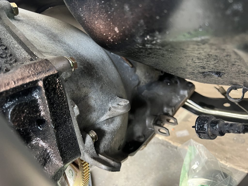

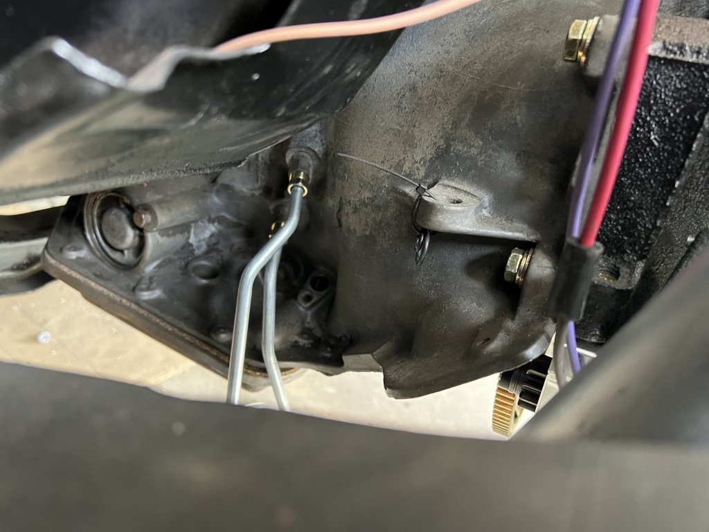

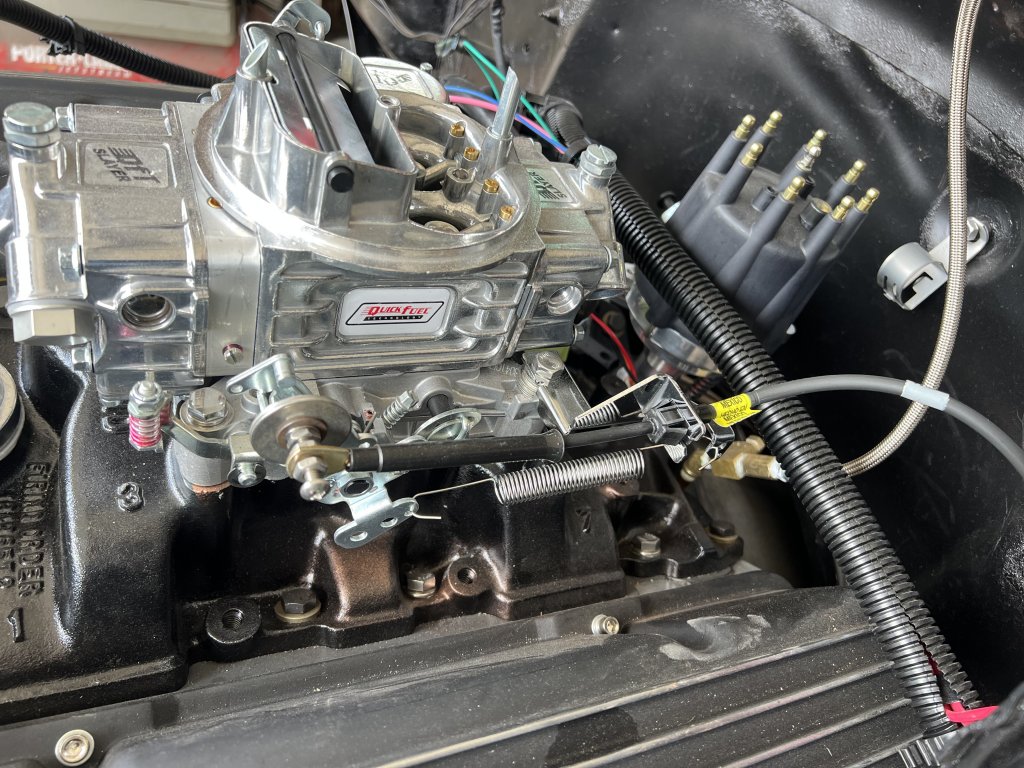

Hi guys,
My truck is a ‘77 C10 sbc400/th350.
The truck was fairly stripped when I got it.
I’m confused about what kind of trans kickdown linkage and speedometer cable I need.
There’s no trans kd linkage there. There are a few options, I think, online.
There is an upper half of a Speedo cable. I don’t think that my year in an Auto 2WD came with a 2pc speedo cable…
Any help is appreciated!
Thanks
4,067
5,918
Okay you need a kick down cable for a 77 c10 with a th350 and a speedometer cable for the same if it has cruise it has an upper cable and a lower cable both going to the cruise transducer, other wise get a cable for a truck without cruise. Your kick down is going to take some working with because you don't have a stock carb or throttle bracket.
