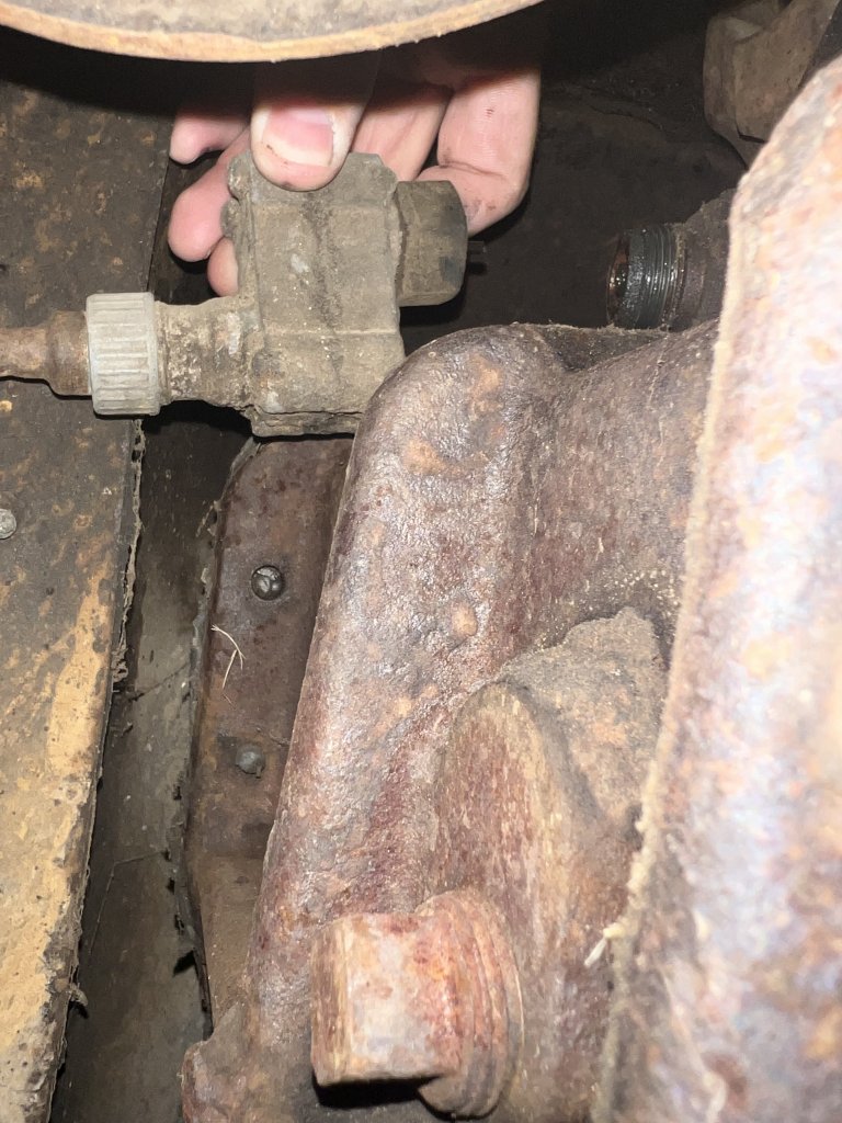

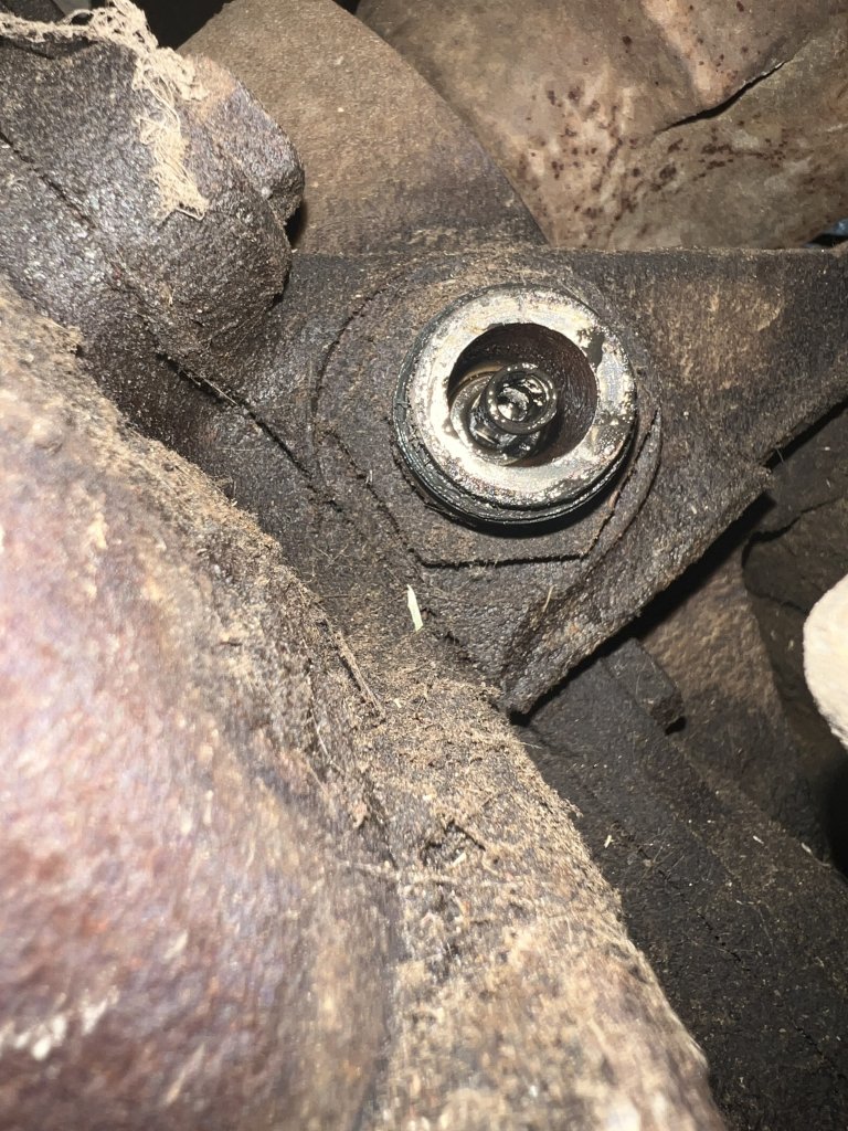

I’ve checked my cable and tried a different gauge to verify everything was working from where the cable connects to the transmission to the gauge itself. Went through and looked at every thread I could find to deal with a speedometer, all 18 pages worth. Powerhouse Ranch’s Speedo gear page was the most informative for me. Main questions I have is on the end of my cable where it goes into the transmission. Appears to be an offset gear box of some sort. Was able to unscrew it from the transmission by hand and was what I used to make sure the gauges bounced. Used my phone to look into where it plugs in. I’m assuming this is the housing for the plastic gear, and all I’m seeing is a spring. Should I see a plastic piece? Also see where what I’m assuming is the housing could be removed with a socket wrench. Everything I’m finding looks a little different than what I have. Could anyone tell me what the little offset gearbox is and if that is indeed the housing for the plastic gear. Messed up to much stuff here lately and figured I’d ask before I ended up with going from no speedometer to no transmission.
