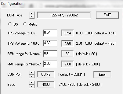

My ecm is 1227747

My ecm is 1227747
attachment.php
Under configuration in WinALDL.
