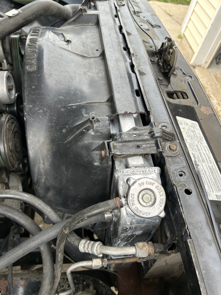

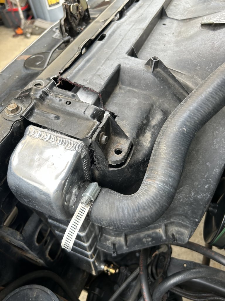

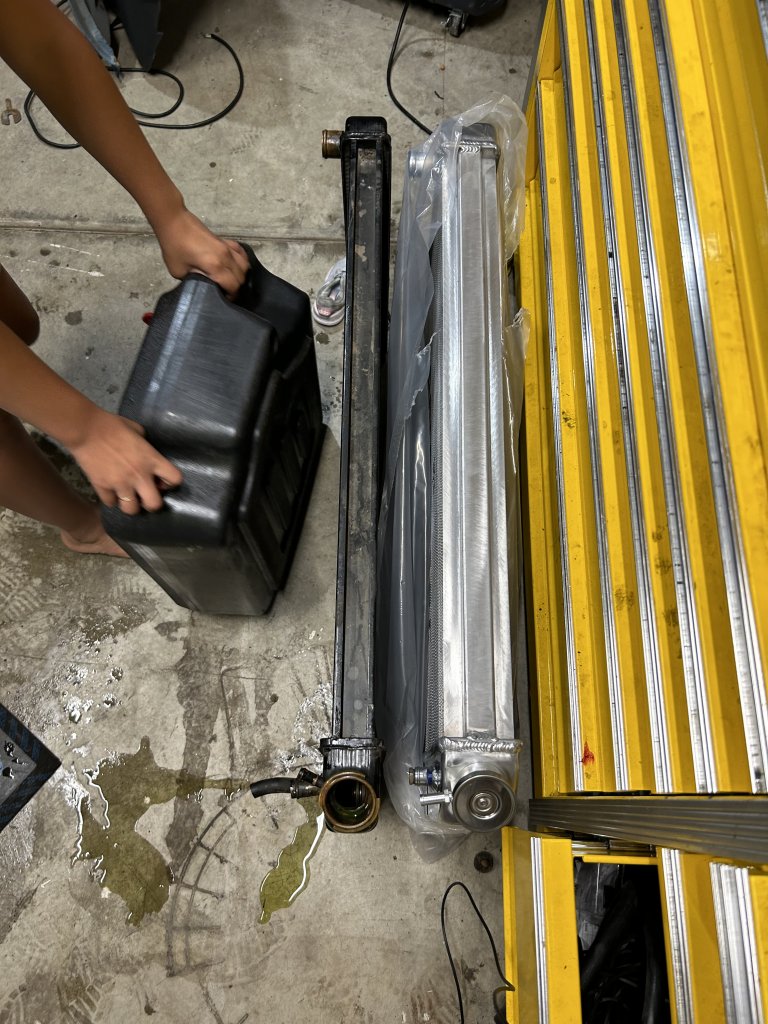

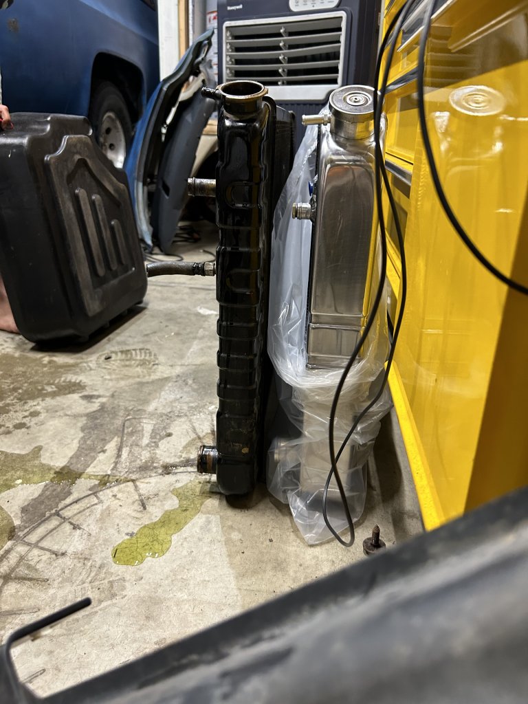

i have a 89 v1500 4x4 350 engine has 40k miles on it the truck has always ran warmer then wanted on a hot day driving around it will get to 220+
airtex high flow water pump
fail safe 180 thermostat
new heatercore
heavy duty fan clutch acdelco brand
new temp sending unit on head and manifold
hyper tech chip witch allows for a 160 thermostat
truck still ran hot so i put on a cold case radiator witch is a oversized two row
still have the same issue any ideas?

Just my 2 cents but, I don't think a 2-core radiator is going to cut it.
Factory used two cores. But I also personally wouldn't use any less than a 3 core.
according to cold case if you have air conditioning and oil cooler in front of your radiator a 4 tow won’t do you any good ?

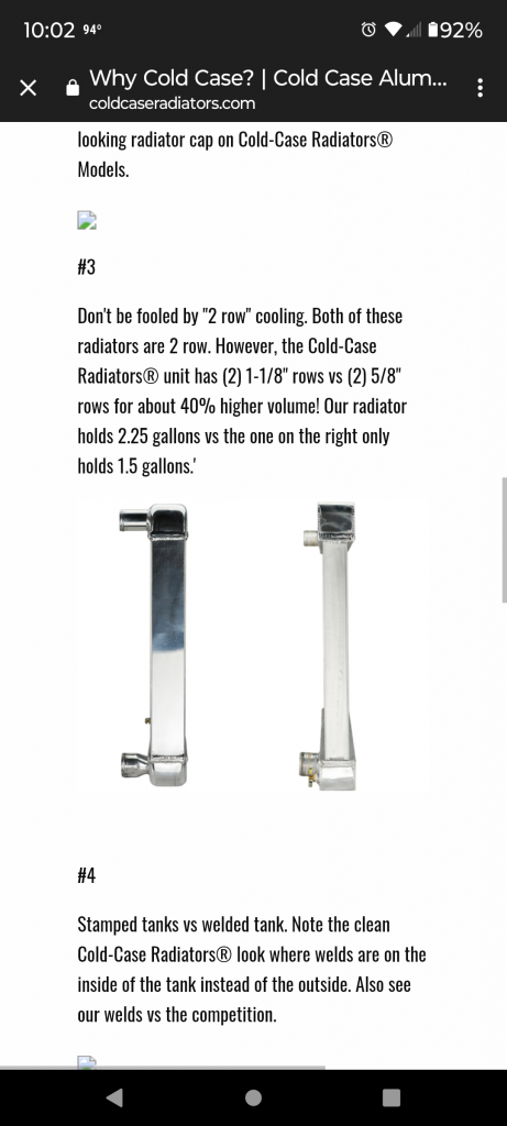

Depends. I have an all aluminum 2 core and it cools my Vortec in 120 degrees with a/c on. Each core is 1-1/2 inches wide.

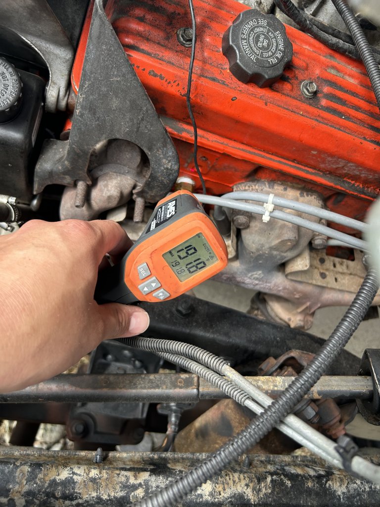

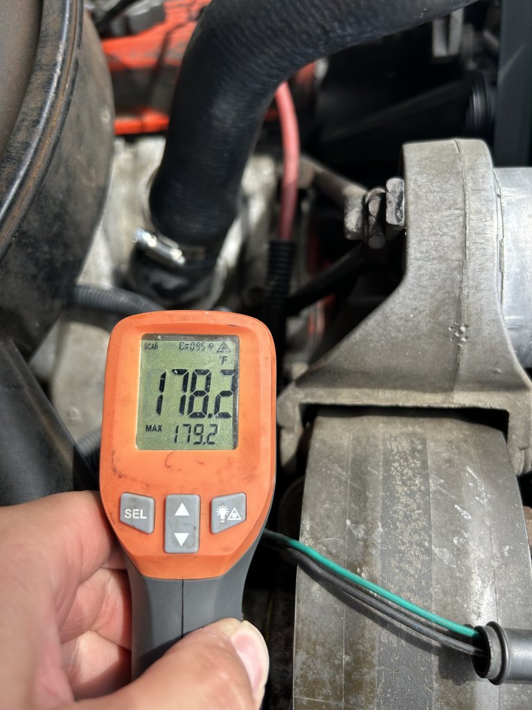

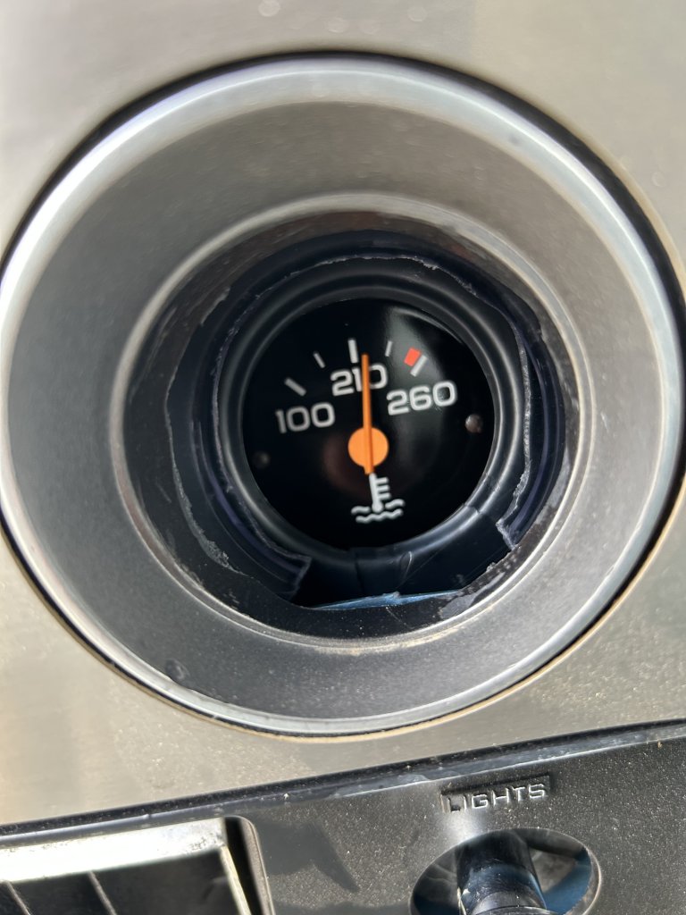

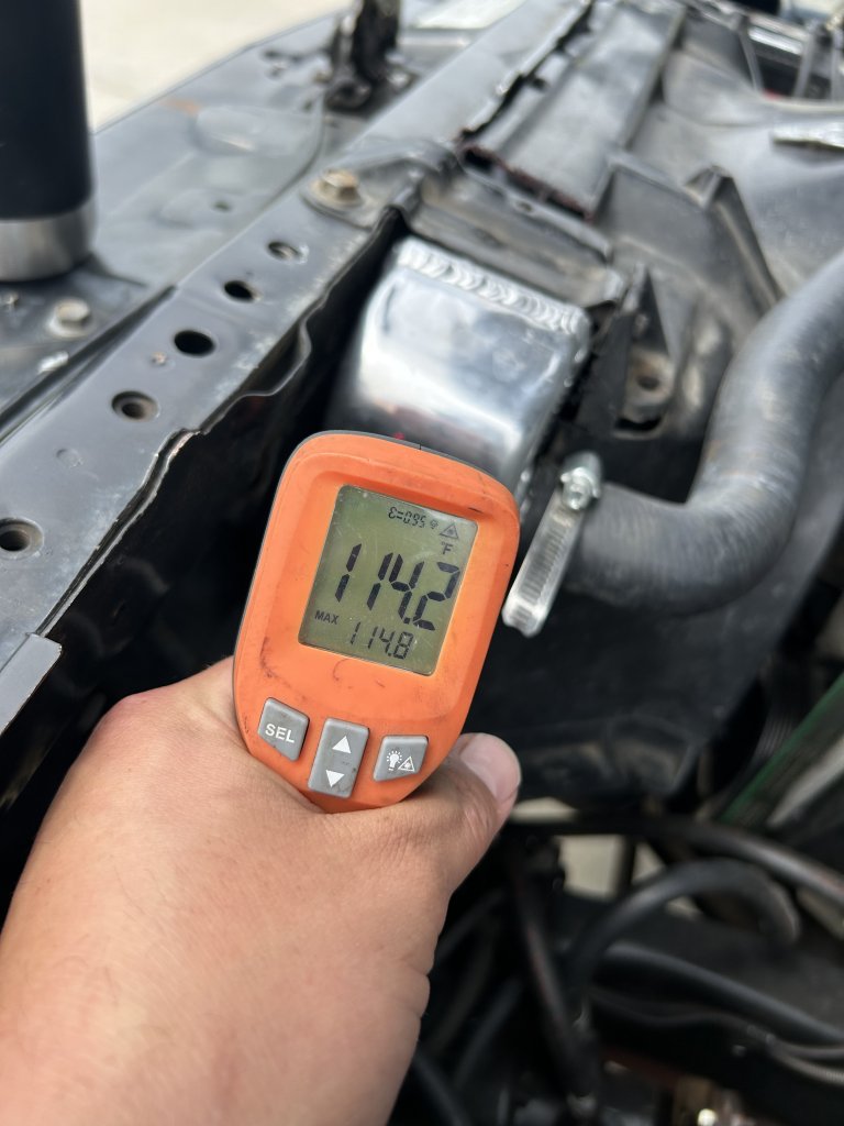

looking like i had two faulty gauges o’reilly gauge was reading 195 on idle factory gauge was reading 212+ used a temp gun i was getting 190 at the heads but figured that wasn’t accurate because it was picking up heat from the exhaust so measured at intake manifold near the ecu temp sensor and was getting 178
