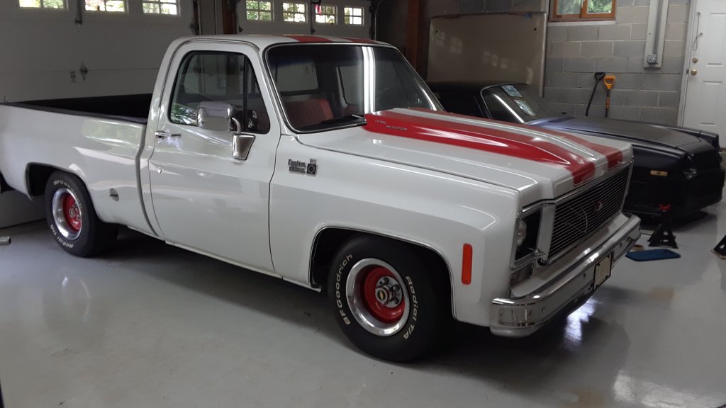

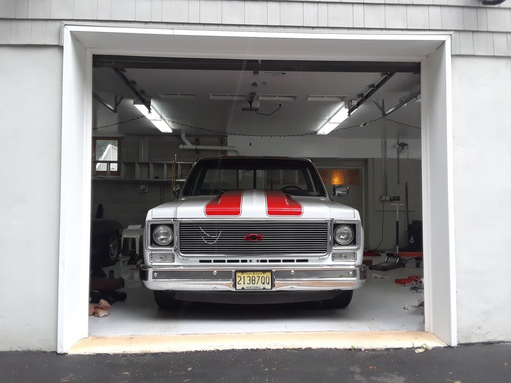

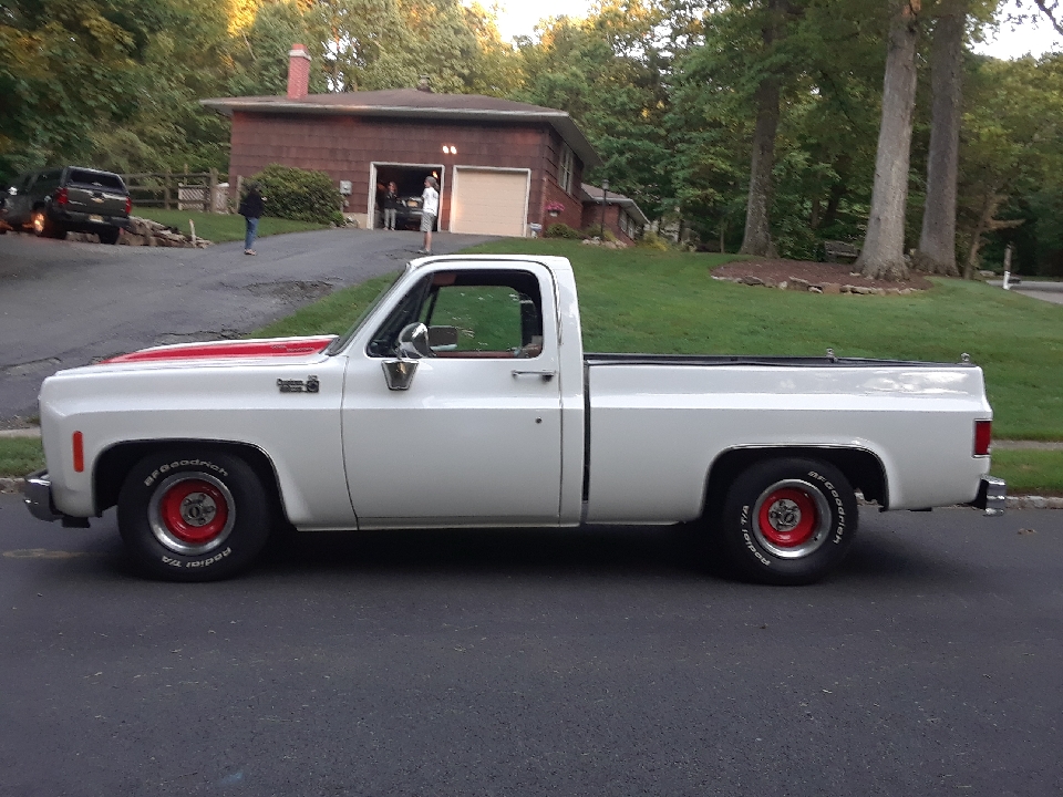

Another update:
I didn't make any changes to the right leaf spring hangers that I mentioned in my last update.
I moved on, and lowered my truck with drop coils, drop spindles, and an axle flip kit.
To my pleasant surprise my truck sits perfectly level now.
Including more info here as I hope it can help others.
As a reminder, the back right sat almost 1.5 inches lower than the back left.
Last year I installed new Husky leaf springs. This made a very small improvement, maybe a quarter inch improvement.
Couple months ago, I installed these parts:
Belltech 2" lowering springs Bell-4702 from Summit Racing.
CPP modular 2.5" drop spindles CLP-CP30106-4 and caliper brackets 6087DBK from Summit Racing. (This modular spindle allows for larger aftermarket brakes. However they dont use brake dust shields... this was a surprise. I also talked to CPP before purchasing about the use of Chevy 15" rally rims. Customer support seemed to have no insights. I knew it might be necessary from other people's posts. Anyway, I had to remove part of the lower control arms. Brake hose fitting on caliper ends needed to be bent to clear the upper ball joint castle nut and cutter pin. If I had a do over I would not get the modular ones.)
DJM axel clip kit FK1024-5 Axle Flip Kit from their Ebay store. (I liked the kit. Brackets seem very strong, included shock mounting bracket. Their instructions could have included more info but it's pretty intuitive. I had to bring away part of the u-bolt plate to clear the kit brack hardware. Pinion angle measured the same as before the flip so their design took care of this. I did not use a frame notch kit. Still plenty of clearance between axle and frame eith no load. They advertise this as a 5-6" drop. Actual was 5".)
If anyone doing a drop would like more info, I would be happy to provide more.
Here are some pics of the end product.

Great looking truck!, I do see a front bumper alignment issue. It’s a little lower on the left (Driver’s side) than the right. Maybe enough to trick the eye? IDK… But I also have OCD ;)
hpp
Jun 5, 2014
17
16
NJ
350 ci
@SquareRoot , agreed.
@FireTruck1984 Thank you. I didn't mean to be literal when I said my truck was "perfectly" level now. I should have said something like, "it looks level now" :)
