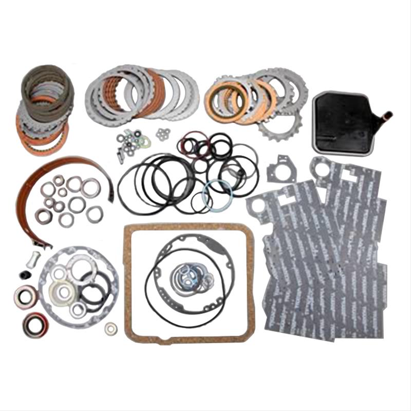

Thanks Nick your the man! We got a good rebuild kit from summit and some of the rubber rings looks like they might be the right size but I’ll check tomorrow to see if they fit.
Here’s the one we got:
NickTransmissions
Aug 3, 2023
537
1,119
Las Vegas
Nick
R10
Maybe they're including viton/rubber D or O-ring seals for that location but every kit I've ever used for those had the cast steel sealing rings...Now that I think about it, I recall a couple kits I had used recently on TH400 builds that lacked a sealing ring for that location...
I didn't need them as I deleted the 2-3 acc circuits on both as those builds were for street/strip applications...In both of those units, I used a 10% pressure regulator spring (increases line pressure by 10% across the board; shimming it by adding a 2nd 'horseshoe shim' adds another 5%), dual fed the direct clutch and removed one of the two springs from the accumulator regulator valve then drilled the spacer plate accordingly...I also installed a Sonnax LB1TH400 boost valve, which is what I use in all my TH400 builds. I like them as they're o-ringed and seal that bore off 100% but Transgo's boost valves are also good...Factory boost valves tend to wear over time and I never re-use them.
