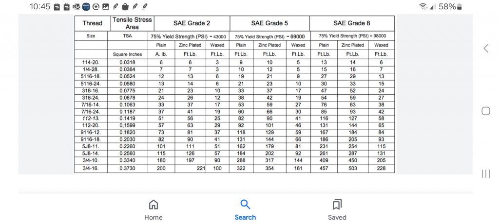

In case you don't find what you are looking for I'll put a thumbnail of an average fastener torque chart. Remember to go by actual diameter and threads per inch. Not wrench size,lots of people do not know that,not trying to insult you.
