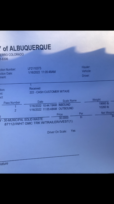

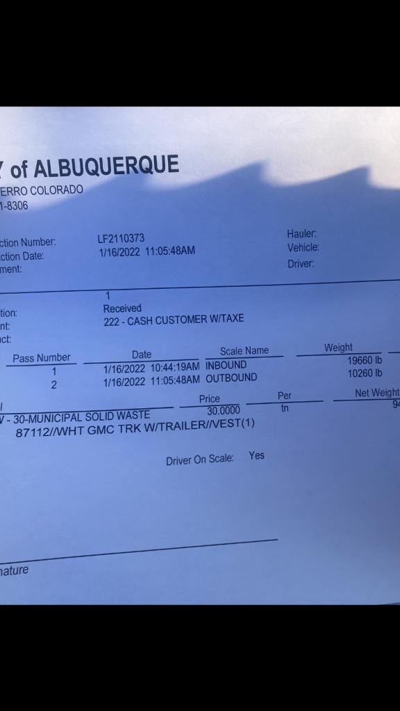

Been doing some remodeling on the house and using my gmc to pull the dump trailer. I pulled a few stumps and some concrete/block and loaded it into my trailer, I didn’t think too much about the weight since I usually pull it with my diesel. So I get to the land fill and was just under 20,000 lbs over the scales.
It wasn’t exactly effortless but the 20 mile drive to the dump would have had me guessing my load was less than that. On the biggest hill I was at 40 mph in 2nd (3rd technically) with a 50 mph speed limit.
My trailer is about 3,200 lbs and it’s content was 9,400 lbs that’s 12,600 lbs in a 40 year old truck and I think that’s pretty cool. I’ve been pulling trailers since I was a kid and at no point did I feel I didn’t have enough truck.

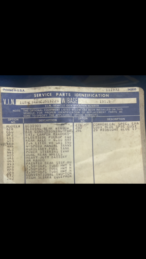

All that aside what’s the max towing capacity on this truck I couldn’t find too much info but one brochure said 13,500 properly optioned/equipped and others said 11,000.
Either way an SM465 and 454 did better than I thought it would. I have no idea what my mpg was and I don’t think I’d wanna know at that weight.
