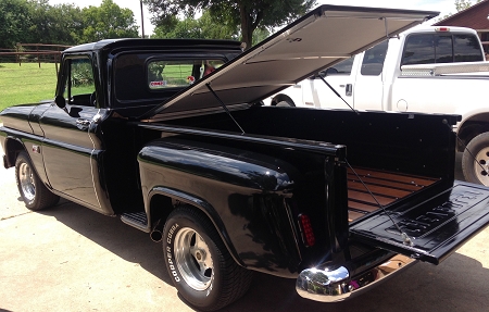

It really takes a long long time for the floor to rot out.
For many years I have had a plan to fabricate my own cover, but I've never followed through yet. The plan is to make the cover out of a marine grade plywood and put a bit of a bevel on the edges. Then wrap the top and edges with a padded vinyl of some kind. The front would be hinged, with quick release pins. I'd incorporate gas lift struts, the lower ball studs would use existing fender mounting holes. If the geometry for the upper mounts (on the cover's underside) is correct, the gas struts won't try to lift the cover until it has been manually lifted a few inches. At the rear, there could just be a simple buckle on each side.
Oh, and none of the hardware would be mounted to the wood with simple screws. There would be machine thread hardware with backing washers and countersunk hardware as needed, to sandwich the wood. Minor differences in the outer surface would be masked by the padded vinyl.
