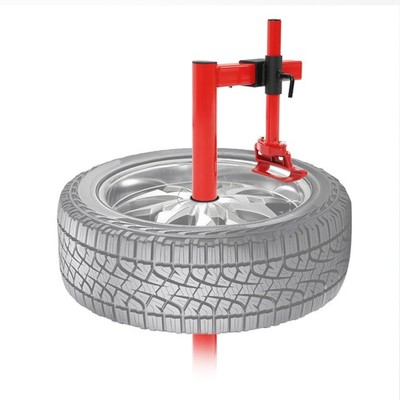

If you aren't going to be doing a lot of tires,a 60.00 harbor freight manual machine with $100.00 worth of mods is hard to beat for the price. IMHO they are worthless garbage as they come. But after adding a good bead breaker to it ($40 from speedway) and a Duckbill kit to it ($60.00) ebay and drilling the base for lugs to hold the wheel down,and welding the mounting base and mounting it to something very Solid. They work pretty good and should do everything you mentioned.
I am considering that option. Good to know it can handle the larger sizes.
Be forewarned they are junk as the come. I did not know this upfront or I would have built one from scratch. But they are an okay base if you you don't have the desire or skills to start from scratch. It will need many mods,but now everything can be purchased or easily made. The speedway beed breaker needs mods as in my previous pics,I made my duckbill,wouldn't again for the price they are available for now. Click on the pardon the interruptions link for the duckbill link.. Pull the pin out of the rim mounting base and drill holes to bolt the wheels down. You can use the 1 hole left by the pin and drill another straight across for 4,6,8 lug wheels drill 2 across like a balance puller for 5 lugs. Click the pardon our interruption text.
