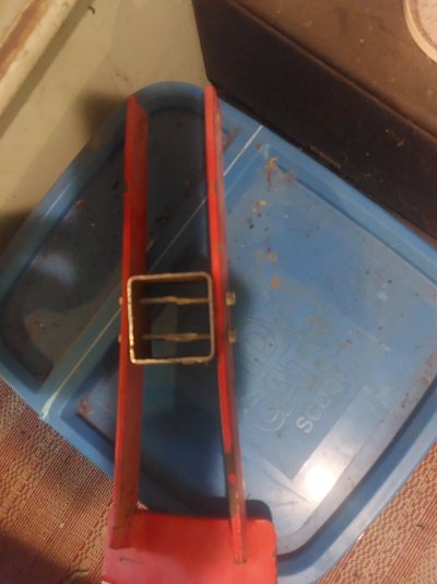

I haven't hid the fact I think the HF tire machine is a POS. But I've had one for years and mod as I go. I'm sure I've said this before drill holes 2 or 3 per wheel depending on the pattern,and bolt the wheel down with lugs. But the bead breaker usually doesn't work if the bead is stuck at all. You would be surprised how this little mod here helps the bead breaker work much better, keeps everything parallel and keeps it from twisting.
