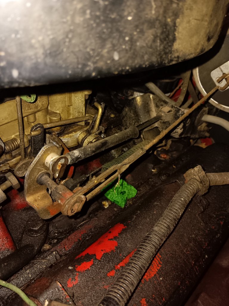

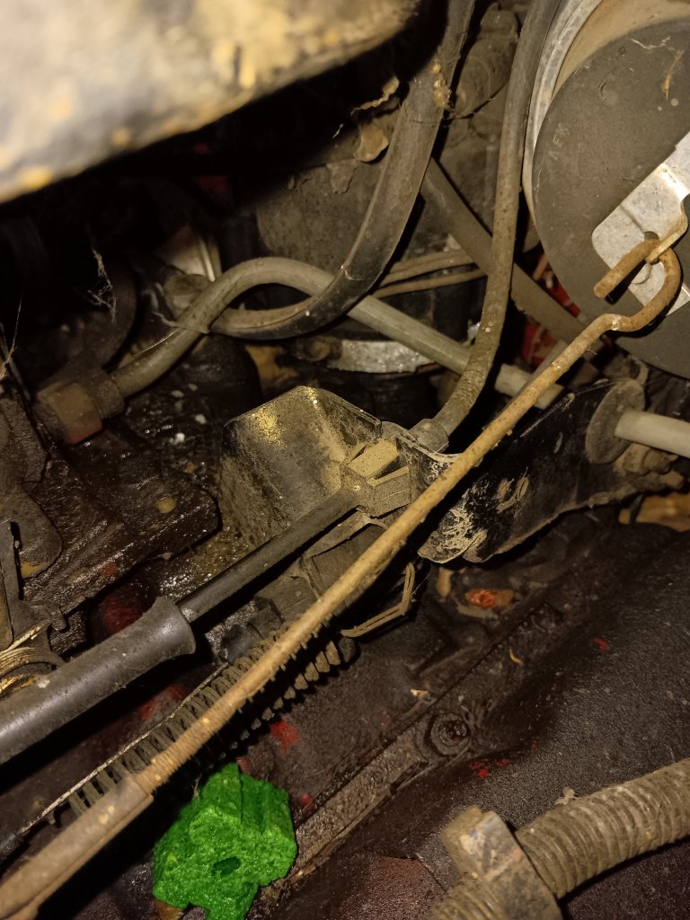

Does anyone have a pic of where the throttle cable bracket goes/mounts on a 350? Converting to a 350 and acquiring parts. Truck is a 1982. Thanks!

I have these of a 1985 carb 305. Should be same as 350. I can try to get a closer up if needed

Your truck, the original throttle bracket would bolt to the two rear carb mounting studs. Running a Holley, I cut the bracket and added a support to a manifold bolt.
Earlier engines the bracket bolted to two manifold bolts.

Converting from a 6.2 to a 400 SBC. Just trying to figure out where this bracket mounts, now that I know I will have to modify it to work with a Holley, actually going to run a Quickfuel. Thanks for the help!
