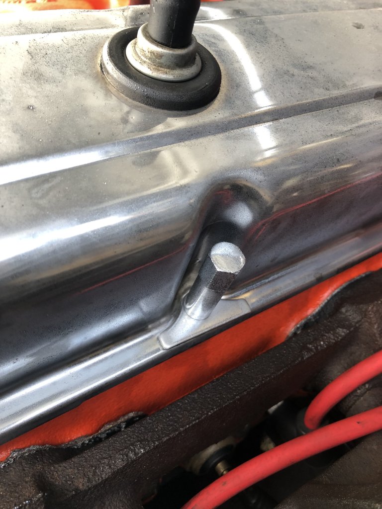

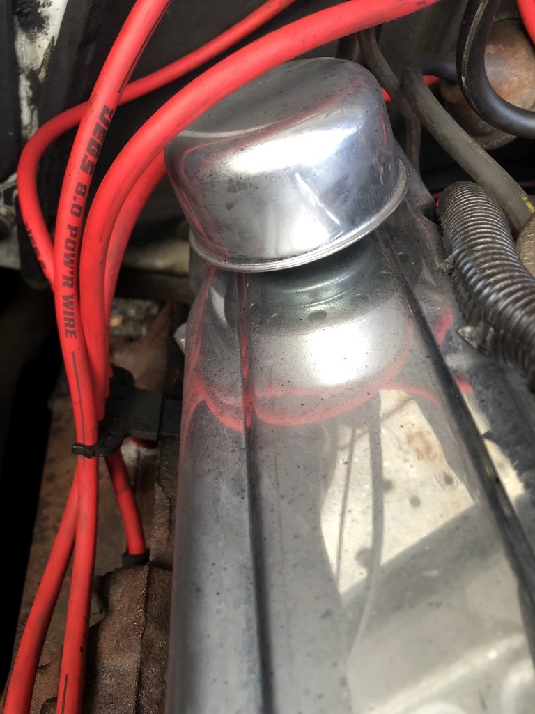

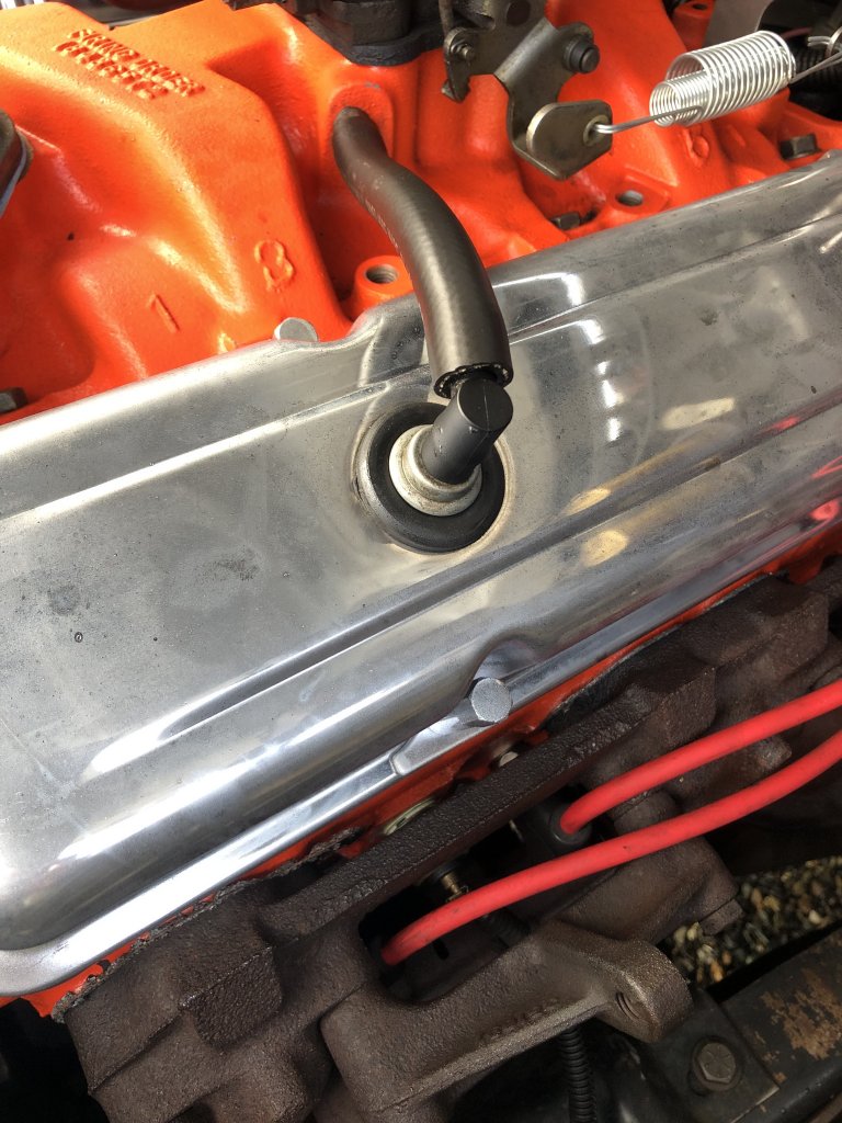

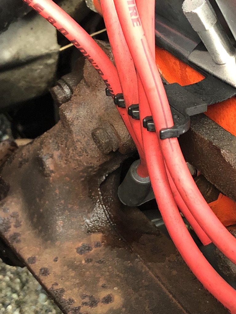

I’ve got the little spreaders under the bolts. I have a PVC valve in the driver side and a breather cap in the other. I don’t know how well the pictures are but you should be able to see the oil soaked on the back of the exhaust manifold and that far back bolt.

@Truck82 Assuming the bolt is the source of the leak, then the head probably has a flaw in the casting or a crack. When you remove that bolt, are the threads oily?
To seal the leak install the bolt with Permatex. Use either number 2 or 3. Silicone will not last. Number 3 Permatex also know as aviation Permatex is probably easiest to apply as it has a brush in the lid of the container. No. 3 is also my go to for sealing leaking valve cover gaskets. Coat both sides of the gasket.

Wipe the area between the breather and the oil spot with a rag. I'll bet oil is venting from the breather and running down.

I pulled the bolts out when I rebuilt the heads in the spring and a few of the bolts in the back leaked quite a bit of oil. Knowing very little then, I didn’t think anything about it and just assumed that was natural. I installed them with a liberal amount of Permatex thread sealer and called it good. Now they seem to be leaking again. When I take the old manifolds off to put my long tubes on I’ll check for sure if it’s coming from the bolt. At least for now only one is leaking. We’ll see how the others hold up. I see no oil coming from the valve covers.

I can tell you for 99.99999 percent positive that you aren't leaking oil from the exhaust bolts them selves the only oil in a SBC head is what pools up top from the pushrods. The exhaust bolts are well below that. The bolt holes are blind holes,and even if someone managed to break through the back off one,the area behind the exhaust bolts would hit a port a guide or a water jacket. If you have one leaking oil it would be an absolute once in a lifetime freak happening.

Looks like I can see the path the oils taking in those pics. Looks like it's running straight down from the valve cover. Don't know how new your paint is or if that's a stain or what? But that's what i see.
I believe that’s condensation? I didn’t see that before and as you can see on the valve covers, it’s very wet here. Now I’m thinking “is that oil!?!?”
Looks like oil to me. Condensation would burn off right away. That's like a dust trail from oil, on the head surface that is.
In the last picture that spot on the manifold is right in front of a spot that looks like oil leaking(behind spark plug holder).
Also an intake gasket can also leak and flow around the valve covers sometimes. But the back of the heads will get real greasy first.
